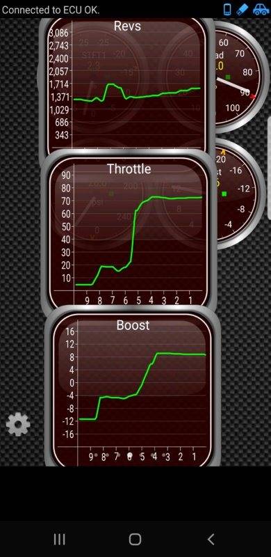

What is the normal behavior of turbocharger boost?
So the other day I plugged in one of those cheap-o OBD-II bluetooth adapters and looked at my car's boost pressure on my phone. Moat of the behaviors look reasonable. Others, not so much.
Car is an Audi A3 etron. Has a 1.4T engine putting out 150 hp and an electric motor putting out 100 hp. This sums to 204 hp. :wink: Normally, 90% of my driving is on electricity, but of course when it is very cold I use gas - the battery range suffers, and if the engine is going to go on at all during the trip, better to use it at the beginning to heat the cabin.
If the engine is off, the boost is zero. This makes sense.
If the engine is running at idle, there's about 12 psi of vacuum. I'm OK with this too.
If I am on the highway and passing (accelerating but not racing), there's 5-6 psi of boost. So far so good.
The weird thing is that when I am at a stop with the engine off, but in hybrid mode, and start to move, if the engine comes on, I am immediately at around 4 psi of boost, and that's at maybe 2000-2500 rpm. The first non-zero number is positive, and it happens under a second after the car starts to move.
My question is how the turbo spins up that fast. When I am stopped, there's no exhaust gas to move it. Shouldn't I see vacuum and then boost? And doesn't 2000-2500 sound like a low boost threshold?

To me the 4psi boost at 2000-2500rpm does not sound odd.
From audi:
"The 1.4 TFSI produces 110 kW (150 hp), and its peak torque of 250 Nm (184.4 lb-ft) is available continuously between 1,600 and 3,500 rpm to harmonize perfectly with the electric motor. "
So 2500rpm is right in the center of its peak torque band, seems to me the turbo is likely sized to push air from about 1200-1500rpm, and if its anything like the Q3 rental I drove, it pulls hard upto about 4krpm and then falls on its face. Clear sign of a small turbo that has very little lag, but not near enough volume capacity as the rpm climbs. Here you need a bigger snail and all the negative (laggy) effects that come with it.
Then:
"When the combustion engine starts, it is tow-started by the electric motor via the clutch. Once its reaches the same speed as the electric motor, the clutch closes. This happens smoothly within a few tenths of a second. "
So the combustion engine is started by the electric main motor, and in well less than a second. I would say that given a hot restart and then immediately delivering torque is likely why you immediately see positive boost. That is what the hybrid system is doing, as quick as possible getting the ICE to start either generating or adding torque "with no detectable interruption of propulsive power ".
https://www.audi-mediacenter.com/en...audi-a3-sportback-e-tron-2624/drivetrain-2635
You have to remember this is no longer a throttle cable to a butterfly on the intake, there is a bunch of computer wizardry happening between your foot and the engine. Driver pedal position is no longer a real indication what the computer is making the engine actually do.
Then you have to also consider the update rate of OBD2, maybe its updating every second, so you could easily miss the start up pressures since they are very short.

Are the zero values identically zero (i.e. without any noise)? If so, then you're likely not getting fed the sensor reading during that time.
I can only answer the second; boost is based on throttle position only, not RPM:
Phone screenshot of an ECU logging app showing three green line graphs: Revs rising from about 1,300 to 1,700, Throttle rising from near 5 to about 70 percent, and Boost rising from about -12 to about 9 psi.
I drive a Kia Stinger 2.0T (non-hybrid). The motor stops at stoplights though, so I'll see if I can capture a launch. The above screenshot was taken coasting into, then going up a hill and stomping on the gas. There's no shifting during the hill climb and the RPM stays pretty low.
I'll take a guess about the fast spinup: Turbo rpm depends on the needed airflow and pressure. With the engine rpm low and throttle open, the airflow is still relatively low. That means relatively low turbo rpm can give high pressure.
