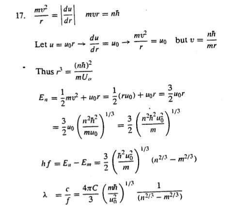

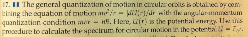

My teacher posted this solution. It is exactly what I had, except I did not have 4Pi in the numerator. Rather, I had 2 instead of 4, and I didn't have Pi. The solution manual has had mistakes before, so I am wondering if that's what the case is here. Every other step, I had identical. Can anyone please verify this? The question is the first attachment, and the solution is the other.
  • Printed textbook problem 17 on quantization of circular orbits: combine mv^2/r = |dU(r)/dr| with mvr = n hbar, for potential U = F0 r.

  • Handwritten derivation for the Bohr-type spectrum of a potential: mv^2/r = |du/dr| leading to mvr = nħ, with u = u0 r, then r^3 = (nħ)^2/(m u0), energy En = (3/2) u0 r, and hf = En − Em, ending in λ = (4πc/3)(mħ/u0^(2/3))^(1/3) · 1/(n^(2/3) − m^(2/3)).
Ohh never mind I was misreading something. Sorry, no help is needed. Thanks.
