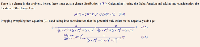

An infinite plane at z=0 is divided into two: the right half of it (y>0) is held at potential zero and the left half of it is held at potential \phi_0
Over this surface lies a point charge q at (0,y_0,z_0)
Use Green's function to calculate the potential at z>0.

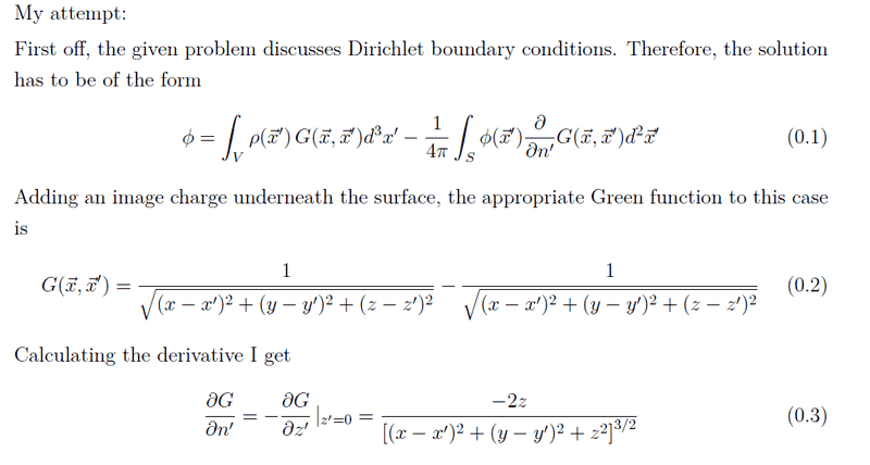

I'd appreciate it if someone could take a look at my attempt at solution as I'm not sure whether what I've gotten to is right or wrong. Mainly because I also have to calculate other things that require taking the derivative of this expression (surface charge density and force acting on the charge).
Also, I couldn't calculate the integral (Wolfram won't read it for some reason) which makes it even more suspicious. If you plug it into some program and you get an answer, please, let me know.Thanks in advance!

Hi, I have answered before. So here I go again. The terms in eq. (0.2) cancel. I think you have placed wrong the image charge (in the same place as the real charge), it should be located at the point ##(0,-y_0,-z_0)##. You will have plus signes in the denominator for the second term in your green's function.
##\frac{q}{\sqrt{x^2+(y+y')^2+(z+z')^2}}##.
Anyway, this image charge will make the whole z=0 plane to be at potential=0. I never worked electrostatic problems with greens function, so I'm not familiar with this. The thing that is left to be done, is to set the other half plane at the potential ##\phi_0##. I don't know if the surface integral in Greens theorem accounts for that (but I believe that it does). You can check Jackson's "Classical Electrodynamics" for reference.

First off thanks for the reply and the care to reply again. I appreciate it.
Second, you are completely right about the location of the image charge location in the z direction (on paper I wrote z+z' but I copied it wrong in lyx). As for the y direction, I don't think it's -y_0.
I think it needs to be the "mirror" charge to the one given from underneath the surface, hence (0,y_0,-z_0).
Don't you think so?
You are correct. Putting the image charge in -y_0 would lead to the Green's function not satisfying the correct BCs. This is an easy check. You are mirroring in the z=0 plane.
As MMS said, the y coordinate should not be mirrored. Inserting z=0 into both potential of the charge and mirror charge should give the same expression with opposite sign.

Sorry for the mistake, you are right, the correct position for the image charge is ##(0,y_0,-z_0)##. What you did seems ok to me now.
MMS said:
Do you see where I could've possibly went wrong?
Why do you think you have gone wrong? (Other than copy paste errors...)

First, you expect the double improper integral to converge for it to be right. No program was able to give me a concrete answer to this (I don't know if I suck at typing functions or it simply doesn't converge to anything).
Second, after finding the potential, I'm asked to find the surface charge density sigma(x,y).
To do so, I'll have to take the derivative of the potential and equalize it to 4*pi*sigma.
This doesn't seem right to take derivatives of double improper integrals. Not to mention it is also multiplied by z, too.
Therefore, I suspect I'm wrong somewhere..

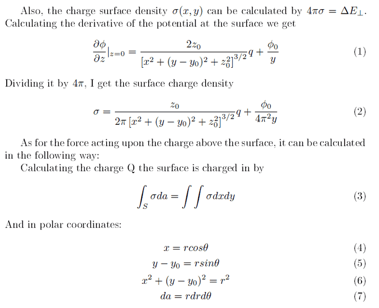

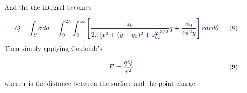

The surface charge density and the force acting upon the charge:
