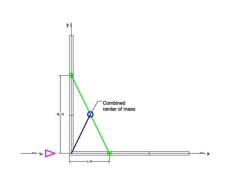

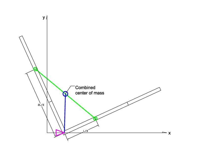

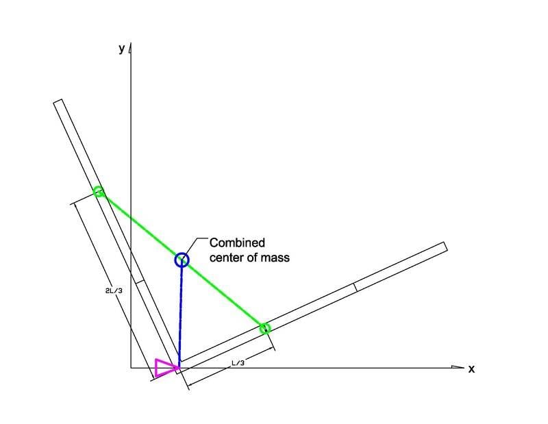

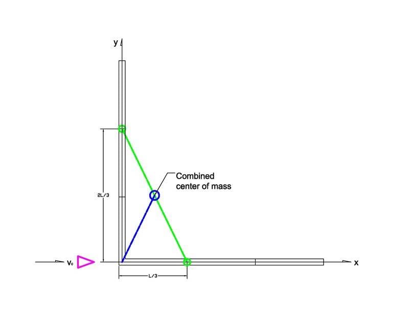

@haruspex
I believe that I was not trying to make any point when I posted those diagrams.
I made them for myself at first, while trying to understand this problem.
Perhaps those could help @songoku clarify the ideas he has shared in his posts 29, 31 and 33.
The exaggerated second diagram and the animated Judo movement show how the common center of mass must move up some for the pivoting point (x-y origin) to try to slide horizontally under it.
Assuming that the frame is rigid and that the horizontal and vertical members remain perpendicular to each other, it seems to me that the collision should simultaneously induce that vertical movement, a horizontal movement, and a rotation in the combined CoM.

Ok, but I worry that students might think you are implying an error in their working. Perhaps when just posting helpful diagrams you could mention the purpose?
