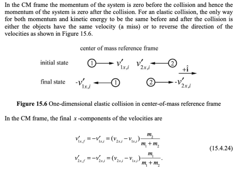

How does the center of mass frame work?
We know the velocity of the center of mass
$$v_{cm}=\frac{m_1v_1+m_2v_2}{m_1+m_2}$$
and we know the velocities of ##m_1## and ##m_2## in the CM frame because
$$v_1'=v_1-v_{cm}=\frac{m_2}{m_1+m_2}(v_1-v_2)$$
$$v_2'=v_2-v_{cm}=\frac{m_1}{m_1+m_2}(v_2-v_1)$$
However, I don't quite comprehend the following
Figure 15.6: Diagram of a one-dimensional elastic collision in the center-of-mass frame, showing initial and final states with velocity arrows for objects 1 and 2, and equations for final x-velocities.
The momentum is zero by definition of this frame.

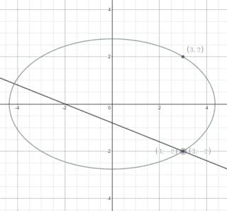

How do we know that "the only way for both momentum and kinetic energy to be the same before and after the collision is either the objects have same velocity (a miss) or to reverse the direction of velocities"?
Where does ##v_{1,f}'=-v_{1,i}'## come from?

Here is an answer to the above
In the CM frame, we have
$$m_1v_{1,i}'+m_2v_{2,i}'=m_1v_{1,f}'+m_2v_{2,f}'=0\tag{1}$$
From (1), we have
$$m_1v_{1,i}'=-m_2v_{2,i}'\tag{2}$$
$$m_1v_{1,f}'=-m_2v_{2,f}'\tag{3}$$
We impose the condition ##\Delta K=0##.
However, we don't use the expression ##\Delta K=\frac{1}{2}\mu(v_{12,f}^2-v_{12,i}^2)## (for reasons I don't yet understand), but we instead use the usual
$$\frac{1}{2}\left (m_1v_{1,i}'^2+m_2v_{2,i}'^2\right)=\frac{1}{2}\left (m_1v_{1,f}'^2+m_2v_{2,f}'^2\right)\tag{4}$$
$$m_1v_{1,i}'^2+m_2v_{2,i}'^2=m_1v_{1,f}'^2+m_2v_{2,f}'^2\tag{5}$$
$$\frac{(m_1v_{1,i}')^2}{m_1}+\frac{(m_2v_{2,i}')^2}{m_2}=\frac{(m_1v_{1,f}')^2}{m_1}+\frac{(m_1v_{2,f}')^2}{m_2}\tag{6}$$
Using (2) and (3) we get
$$(m_1v_{1,i}')^2=(m_1v_{1,f}')^2\tag{7}$$
and so
$$v_{1,i}'=\pm v_{1,f}'\tag{8}$$
Now, if ##v_{1,i}'=v_{1,f}## then the momentum equation (1) gives us ##v_{2,i}=v_{2,f}##.
Thus, in this case, we have that the relative velocity does not change. There is no collision.
If ##v_{1,i}=-v_{1,f}## then bu adding (2) and (3) we obtain
$$-m_2v_{2,f}'-m_2v_{2,i}'=0$$
$$-m_2(v_{2,f}'+v_{2,i})=0$$
$$v_{2,f}=-v_{2,i}$$
So in this case the initial velocities change sign.
Clearly both of those options satisfy the conservation laws.
Draw two graphs of the one velocity against the other. A straight line represents conservation of momentum, while an ellipse represents conservation of energy. They can only intersect in two places.
Why have I never thought about it like that?!? This is brilliant!
That the velocities are reversed in the CoM frame also becomes obvious as the ellipse is centered on and the line is through the origin!
This is why PF is great! Every once in a while you stumble across some insight that you somehow overlooked throughout your entire physics carreer!
