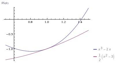

Here is the question:
Calculus Help Please?
Find the point where the graphs of f(x)=x^3-2x and g(x)=0.5x^2-1.5
are tangent to each other; or have a common tangent line.
I'm pretty sure I have to find the derivatives of each and set them equal to each other. Do I then just solve for x? My answer is seems weird. Can you explain how you would go about this problem please?
Thanks.
I have posted a link there to this topic so the OP can see my work.
Hello Mikey,
If the two given functions are tangent to each other, then the difference between the two functions will have a repeated root:
$$f(x)-g(x)=(x-a)^2(x-b)$$
$$x^3-\frac{1}{2}x^2-2x+\frac{3}{2}=x^3-(2a+b)x^2+\left(a^2+2ab \right)x-a^2b$$
Equating corresponding coefficients, we find:
$$2a+b=\frac{1}{2}$$
$$a^2+2ab=-2$$
$$a^2b=-\frac{3}{2}$$
The third equation implies:
$$b=-\frac{3}{2a^2}$$
Using this, the first equation gives:
$$4a^3-a^2-3=0\implies a=1,\,b=-\frac{3}{2}$$
And so the two functions are tangent to one another at $x=1$. Here is a plot:
