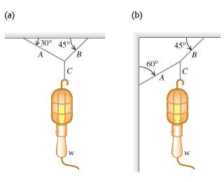

Find the tension in each cord in the figure, if the weight of the suspended object is w.
1)Find the tension of the cord A in the figure (a)
2)Find the tension of the cord B in the figure (a).
3)Find the tension of the cord C in the figure (a).
4)Find the tension of the cord A in the figure (b).
5)Find the tension of the cord B in the figure (b).
6)Find the tension of the cord C in the figure (b).
I got the solutions, but I want to learn how to do this problem.What I have done is broken down the tension into x and y components.
as so: http://img399.imageshack.us/img399/7552/98301308qg2.jpg
if they are in equilibrium then the total force is 0.

I progressed some more (hopefully what I did is in the right track):
Sum of Fx =
Acos30 = Ax
Bcos45 = Bx
Sum of Fy =
Asin30 = Ay
Bsin45 = By
w = Cy
Solutions: 1).73205w 2) .896575w 3) w 4) 2.732w 5) 3.346w 6) w

Signs matter. I'd say:
Ax = -Acos30 (because it points to the left)
Bx = +Bcos45
Sum of Fx = 0, so:
Ax + Bx = 0
-Acos30 + Bcos45 = 0
That's one equation.
Sum of Fy =
Asin30 = Ay
Bsin45 = By
w = Cy
Correct the signs and write the vertical equilibrium equation. That's your second equation. You can solve them together to get A and B.
so it would be:
Sum of Fx::: -Acos30 + Bcos45 = 0
Sum of Fy::: Asin30 + Bsin45 -w = 0
now, the A's cancel out, and it would be 2Bcos45sin45-w=0...b=w? can't be. :(

Good.
What do you mean they cancel out?
Write one variable in terms of the other (from one equation) and substitute (into the other equation).
Acos30 = Bcos45
A = Bcos45/cos30
etc...
ok so it would be
Bcos45/cos30 + B sin 45 -w = 0
.81649658B + .707106781B - w = 0
1.523603361B = w
B = w/ 1.523603361

You forgot the sin30 in the first term.
B(cos45/cos30)(sin30) + B(sin 45) -w = 0
B (.81649658)(.5) + B (.707106781) -w
.40824829B + .707106781B - w = 0
1.115355071B = w
B = w/1.115355071
Looks OK.
but the answer for the tension of B is "T_B =.896575w" O_o
but if I try doing it like this:
((Bcos45)/cos30)(sin30) + B(sin 45) -w = 0
instead of this
I get .8164962w
good enough?
Realize that B/1.115355071 = (1/1.115355071)B
Calculate 1/1.115355071
:O
wow, forgot about that 1 in the numerator.
thank you for your help. :)
