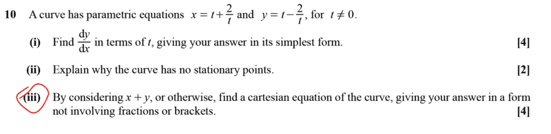

This is a past paper question...see attached (my interest is on the highlighted) I used a different approach thus your insight would be great. I always make it a point to try out the questions before checking what the mark scheme offers...
parametric equations.
Find ms solution;
My approach;
##xt=t^2+2## and ##yt=t^2-2##
##xt-2=t^2## and ##yt+2=t^2##
##⇒xt-2=yt+2##
##xt-yt=4##
##t(x-y)=4##
##t=\dfrac{4}{x-y}##
We know that;
##x+y=2t##
##x+y=2⋅\dfrac{4}{x-y}##
##(x-y)(x+y)=8##
##x^2-y^2=8##
Your insight is welcome...rather asking if this approach would be correct.
[tex]x+y=2t[/tex]
[tex]x-y=\frac{4}{t}[/tex]
[tex](x+y)(x-y)=8[/tex]
Writing [tex] \begin{split}<br /> x &= t + \frac{2}{t} = 2\sqrt{2}\operatorname{sgn}(t)\cosh(\ln(|t|/\sqrt{2})) \\<br /> y &= t - \frac{2}{t} = 2\sqrt{2}\operatorname{sgn}(t)\sinh(\ln(|t|/\sqrt{2}))\end{split}[/tex] shows that the curve is a hyperbola, and basic identities then give [tex]x^2 - y^2 = (2\sqrt{2})^2 = 8.[/tex]
