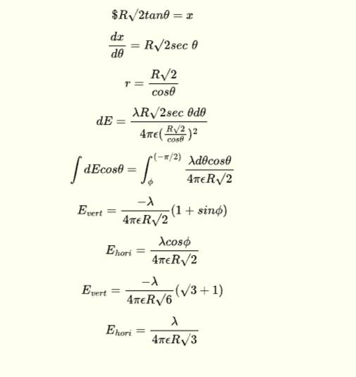

3 semi infinite rods are placed along x, y and z axis such that the points on them obey x > 0,y>0 and z>0 and their common end is origin. Find Electric field at (R,R,R)
None
I tried resolving the semi infinite rods into arcs of 90 degree each placed on the three axes but that doesnt take me anywhere....
Alternatively I tried finding out the field at the point due to each rod but im unable to find the perpendicular distance from the point to the rod...I dont think such a distance exists..I know I should use integration but im having a hard time doing anything in 3d. Can someone give me a starter ..

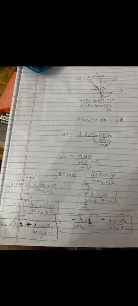

Okay so it took a while but I did do this I found out the perpendicular distance from x axis to be R√2. Now im having trouble integrating since I am unaware what to put in for the lower limit, the upper limit is 90 but the lower limit ends up being an unknown..s
The ##R\sqrt{2}## answer is correct. If you want additional help with your integral, please provide the drawing on which you based it plus the expression of the integral itself. I cannot read your mind and I won't even try.

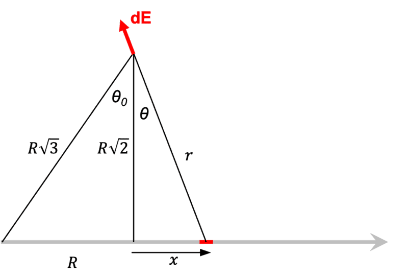

$$ R√2 tan \theta = x $$
$$ \frac {dx} {d\theta} = R√2 sec²\theta $$
$$ dE = \frac { \lambda R √2 sec²\theta d\theta} { 4 π \epsilon ( \frac { R√2} {cos \theta} )^2 } $$
$$ \int dE cos \theta = \int_\phi^{(-π/2)} \frac {\lambda d\theta cos \theta } { 4π \epsilon R√2} $$
$$ E_{vert} = \frac { - \lambda } { 4 π \epsilon R√2} ( 1 + sin \phi) $$
$$ E_{hori}= \frac {\lambda cos \phi } { 4π\epsilon R √2} $$

The angle between the perpendicular line and the line joining the point to the origin is ## \phi ##
So ##\cos(\phi)## and ##\sin(\phi)## are… ?
Also keep in mind that the component you call ##E_{hori}## is along the x-axis, however component ##E_{vert}##, although perpendicular to the ##x##- axis, is not parallel to either ##y## or ##z##. You need to be careful about how you add the contributions from the other two wires. Alternatively, you can use a symmetry argument.
Right the former is ## \frac {√2} { √3} ## and the latter becomes ## \frac {1} {√3} ##

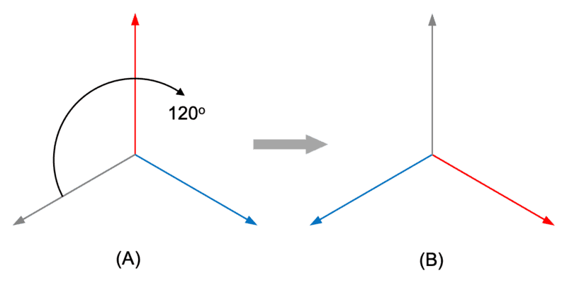

I was thinking of finding the magnitude of net E from the two components and doing the same for the other axes and since the net E from the three axes must be mutually perpendicular(?) I am gonna use that to find the total E....doe this sound wrong??
For each axis, there is an E component normal to that axis and one parallel to it.
The parallel three will be normal to each other, but what about the first three? Is the line x=y, z=0 normal to x=z, y=0?
Even if both triplets were to consist of three orthogonal vectors, would that prove the three resultants are mutually orthogonal?

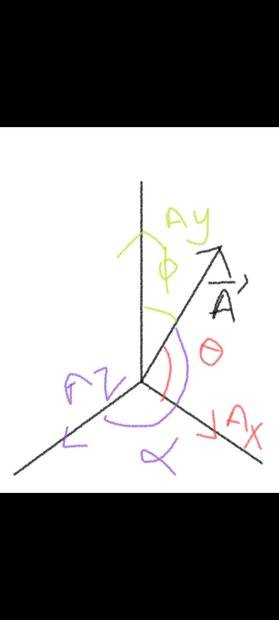

Sorry for the late reply I keep trying then giving up. I have some questions for a normal 3D vector I figured out:
The magnitude of the components are the cosine of the angle the vector makes with the axis times the magnitude of the resultant. Thats ok
But for a vector like this which starts from the middle of the axis and goes till a point in space
How do I resolve this? I understand this is a sum of two vectors so do I find those two vectors and their components...?
I understand that you're trying to stress on the fact that its quite easy to figure it out but im having a hard time convincing myself so imt trying to prove everything... Sorry

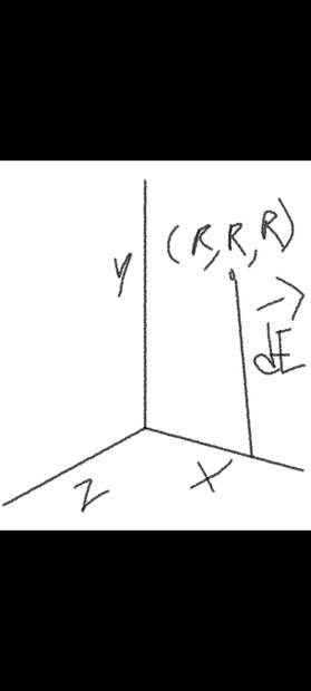

How did you figure out the horizontal component is parallel to the x axis ?

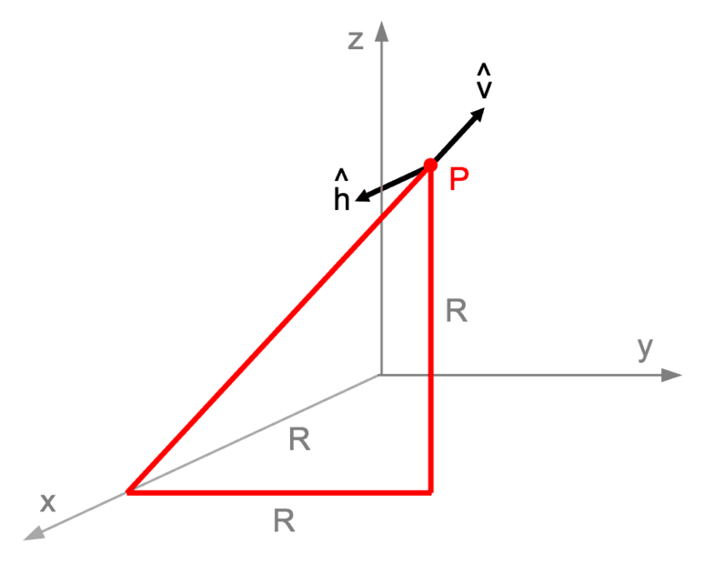

I looked at your drawing in post #10. The plane of the screen is the same as the plane of the triangle formed by the wire (along the x-axis), side ##R\sqrt{2}## and side ##R\sqrt{3}##. The "horizontal" direction, unit vector ##\mathbf {\hat h}##, is along the x-axis and the "vertical" direction, unit vector ##\mathbf {\hat v}##, is along side ##R\sqrt{2}##. So the contribution from the wire along the x-axis is $$\mathbf{E}_1=E_{hori}~\mathbf {\hat h}+E_{vert}~\mathbf {\hat v}.$$
Now look at the drawing on the right. P is the point of interest (3,3,3). The plane of the red triangle is parallel to the ##yz-##plane at distance ##R##. Clearly ##\mathbf {\hat h}=\mathbf {\hat x}##. Can you write ## \mathbf {\hat v}## as a linear combination of unit vectors ##\mathbf {\hat y}## and ##\mathbf {\hat z}##? If yes, then a cyclic permutation of the axes should give you the contributions from the other two wires. There is also a symmetry argument that allows you to find the direction of the resultant field without adding any vectors. Can you formulate it?

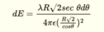

The negative sign bothers me. For positive ##\lambda## the vertical component ##E_{vert}~\mathbf{\hat v}## must point away from the wire in the direction of ##~\mathbf{\hat v}##. The negative sign implies "towards the wire."

It all makes sense. All I needed to do was use technology to make a diagram the diagrams on my 2 dimensional notebook page made it more confusing. If you can please let me know what you used to create this diagram... I thought of paint 3d..I have the angle from the diagram and the components but im sure I am not wise enough to find the symmetry argument so ill not look that way. About post 26 im sure its a mathematical error I'll fix that asap. Thanks a ton
Not a wise comment sorry its pretty evident its just a 2d diagram..I just need to be clear in my work

Okay so I did this again... Im getting the same expression which is definitely wrong..I know this is not a check my work site and Youve already helped me directly by literally drawing me a diagram but can you check the integration and give me a hint as to where i went wrong..?
Im my opinion the E sin theta component is also wrong since its positive but if you analyse the sum of the components along the x axis should point in the negative x direction..
