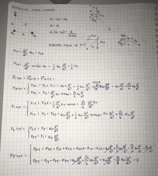

https://www.physicsforums.com/threads/find-the-electric-field-in-the-point-p-of-a-right-triangle.965285/#post-6125768 knowing that the three charges are equal and that the angles of the triangle are 90°, 45°, 45°.
I tried solving it by calculating the total force on each charge, decomposing it
on the X and Y axis and calculating then the total force acting on P. But I'm not sure if it is correct:

Welcome to the PF. :smile:
First, if the charges Q1, Q2 and Q3 are all the same, and the point P is equidistant between Q1 and Q3, what can you say about the net electric field at P due to those two charges?
Second, the problem is asking for the E-field at P, not the net force. Can you write the simplified equation for the E-field at point P now that you've thought about the net field from Q1 and Q3?
I am mystified by your working. You seem to be calculating forces between the three charges. These have nothing to do with the question asked.

The net field due to Q1 and Q3 is 0; so the electric field will be E = k Q2 / r^2, where r is the distance between Q2 and P.
Is it correct?
Is it correct?
Right.
Correct. Now all you have left to do is express r in terms of the given distance d. :smile:
