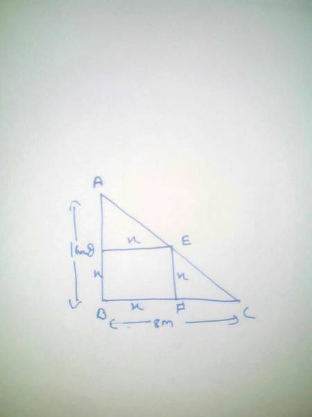

Find the length of largest square accommodated in a right angled triangle whose perpendicular length is 16 m and base's length is 8 m.
My attempt
I have tried a lot to find the length but every time it comes in fraction , i think that the figure i have made is wrong
. The answer I am getting is 16/3,could anybody tell me whether i am right or wrong.
Seems right. How you are getting the answer is maybe more interesting than just the diagram.

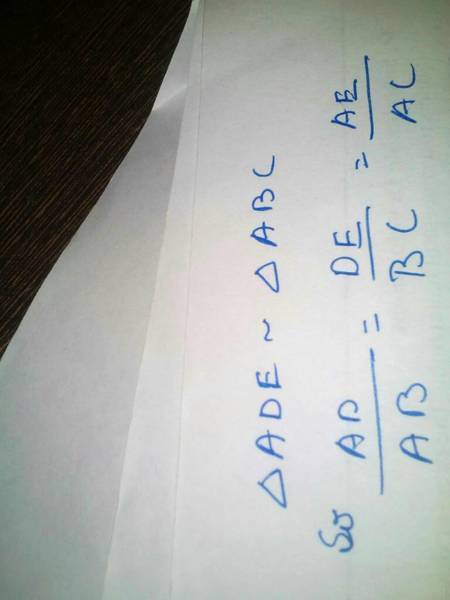

I have only applied the concept of similarity in which triangle ADE Is similar to Triangle ABC and thus from the photo below u could find the value of x.
Sounds right. I think 16/3 is correct.

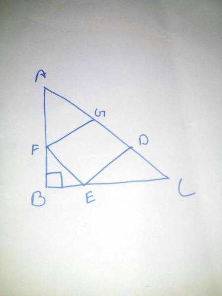

Suppose the square is in this case then
Quite so. It remains to compute the size of the square in that arrangement and see which is bigger.

Going by your diagram, EF is parallel to AC and since the gradient of AC = -2, then let F cut the y-axis at y=a. Now you can find where E cuts the x-axis in terms of a, then you can find the length of EF, and so you just need to find an expression in terms of a for the parallel distance between EF and AC. What gradient would a line perpendicular to AC have?
Find similar triangles again. What is the ratio y/x comparing the small right triangle PQC with the big one, BAC? Also, x2+y2=a2. How are x and y related to a?
The yellow triangle is also similar to the big one. You can write an equation among the sides...

Thanks sir ehild I got it , I was knowing about you from one of my friend #satvik pandey , you are great.Thanks man.

I tried this.
As ##\triangle ACB\sim \triangle QCP##
So ##\frac { 8 }{ x } =\frac { 8\sqrt { 5 } }{ a } ##
or ##\frac { 8 }{ x } =\frac { 8\sqrt { 5 } }{ { x }^{ 2 }+{ y }^{ 2 } } ##
or ##x\sqrt { 5\quad } ={ x }^{ 2 }+{ y }^{ 2 }##
But ##y=2x##
So ##x=\frac { 8 }{ \sqrt { 5 } } ##
but ##a=\sqrt { 5 } x##.
So ##a=8##
This is larger than 16/3.
Is this the answer of this question?

##a=\sqrt{x^2+y^2}## and y=2x, so your equation transforms to ##\frac { 8 }{ x } =\frac { 8\sqrt { 5 } }{ \sqrt{ x ^ 2 + y ^ 2 } }=\frac { 8\sqrt { 5 } }{ \sqrt{5 x^2 }}=\frac{8}{x}##:-p

Yes I did a silly mistake.Sorry:-p
As ##\triangle ABC\sim \triangle PFB##
F is a point of intersection of red line passing through P and AB.
So ##\frac { 16 }{ a } =\frac { 8\sqrt { 5 } }{ 8-x } ##
or ##16-2x=\sqrt { 5 } a##
so ##x=\frac { 16 }{ 7 } ##
So ##a=\frac { 16\sqrt { 5 } }{ 7 } ##

It is correct now! :thumbs:
