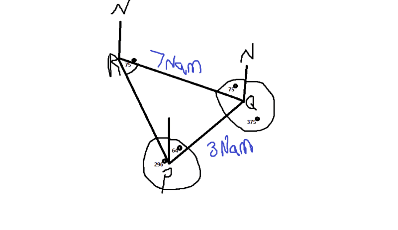

A ship sails 3 nautical miles from Port P on a course of 64° to Port Q, then changes course to 285° and sails a further 7 nautical miles to Port R.
(i) Draw a carefully labelled diagram of the entire route taken. Show the north direction where necessary.
(ii)Calculate the distance PR to three significant figures.
(iii) Determine the bearing of P from R.
I have drawn the diagram which i will post, as you can see I found angle PRQ to be 75° using alternate angles, and I found the exterior angles of the first two bearings by subtracting them from 360°.
But I can't seem to figure out the other two angles in the triangle to find the length, I could simply use the sine rule then°
PLEASE NOTE ON THE DIAGRAM THE ANGLE WHICH SAYS 375° SHOULD BE 285°

Here is a full size image of your diagram:
Can you determine angle PQR ?

The angle that says 375 should be 285 just to correct that.
I am trying to figure it out... But I Just can't see it, I think it may have to do something with opposite interior angles.

You found the yellow angle as 75° correctly. What is the pink angle then? The angle PRQ is not 75°.
If you know the pink angle, you can calculate the length PR, and then all angles can be determined.

Oh I see Ehild...it makes a corresponding angle... and therefore it would be 180-64+75=41° and I can use the cosine rule... It's actually a bit hard to visualize.. I won't forget this.
Richie Smash said:
Oh I see Ehild...it makes a corresponding angle... and therefore it would be 180-(64+75)=41° and I can use the cosine rule... It's actually a bit hard to visualize.. I won't forget this.
Yes, go ahead.
Yes I did it, using the cos rule the length is 5.13, and then for the bearing, if You extend a line from R and call the other point S then the angle NRS is 75° due to the same corresponding angles, so therefore angle NRQ would be 105°.
SO the bearing would be 105°+22.6°(angle PRQ) = 127.6° and it is very correct :) solved thanks a lot guys.
