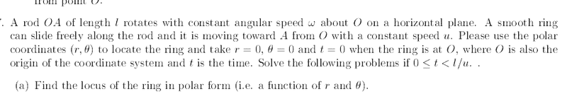

the question is showed below
i know that x=rcos θ and y= rsinθ and x^2 + y^2 = R^2
but i just dun know how to find the locus is polar form
any clue ?

All you have to do is to find the position of the ring in terms of r and θ.
It's easy to get r in terms of t and also θ in terms of t.
That gives you two formulae - you just have to eliminate 't' between them.
u mean
r= (u)t
and
θ= (w)t
so
rw=uθ and then rw-uθ=0 ??
actually i have listed this equ but i just don't believe my self
i feel that i have missed something

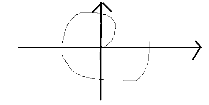

If you're not sure, draw the locus (path).
Note that rω = θu can be written as r = kθ where k is a constant - that's easy to plot.
AJ Bentley said:
Ya got to have faith.
the path will be something like a @ ??
ya i got it, thx
