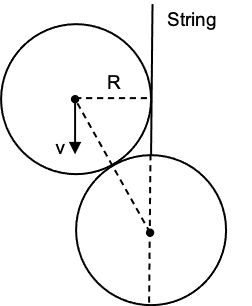

  • #63
kuruman said:
Why point masses?
Here is the diagram at the time of the collision assuming that the balls have the same radius ##R##. It seems to me that the momentum of the two-ball system is not conserved in the vertical direction because the string constrains part of the system from moving in that direction. Assuming that there is no friction while the balls are in contact, the top ball delivers an impulse directed along the center-to-center direction which can be calculated from the geometry.
Whatever component of velocity the secondary ball had along the collision line (line of centres per Kuruman's diagram above) is lost. The ball retains the other component perpendicular to that.

You can't treat it as two separate events: the collision of the balls and the impulse from the string. It all happens at once, and I would expect some of the string's impulse to feed back into the rebound of the falling ball. In effect, the hanging ball has greater inertia.
Well I thought about exactly that. And came to the conclusion that if the string has "negligible" mass and is perfectly elastic, the implication is that the instantaneous collision is only between the two balls. The primary ball moves 'out of the way' before any of the string's impulse can 'feed back' to the secondary ball. Otherwise as you've pointed out, we start needing information about the string's spring constant and its tensile strength.
Edit 1: Put another way if the chord is something like a bungee chord which can extend (for practical purposes) indefinitely, then there will be negligible energy transfer to it over the very short collision ##\Delta t##.
Edit 2: ##k\Delta x << \frac{\Delta P}{\Delta t}## where ##\Delta P## is the collision impulse , k is the spring constant and ##\Delta x## the extension over the brief collision period ##\Delta t##.

Fwiw, I have now simulated it, ignoring gravity.
For some arbitrary choices of initial ball speed, mass, etc.:
- With the string having a tenth the spring constant of the ball pair, the left hand ball loses contact with a trajectory of 30.6o below the horizontal.
- With the ball pair and string having the same spring constant, the trajectory is 21.5o below the horizontal.
- With the string having ten times the constant, the trajectory is 13.1o above the horizontal.
So as I surmised, if all is elastic, the relative spring constants are crucial.
Edit: although I intended to ignore gravity, I made the mistake of taking the string as always in tension. I need to allow it to go slack. So ignore the above results.

  • #70
Case 1 limiting value would be ##30^{\circ}## below the horizontal as per physics of an oblique elastic collision between 2 equal masses. Perhaps we can also find a limiting value for case 3 ?
Edit: In your simulation , could you perhaps set the string's spring constant to 100 times that of ball pair system ?

  • #73
Having managed to tame the simulation somewhat (by taking any three consecutive values of a position or velocity coordinate to follow a quadratic) I am satisfied that when the string's spring constant is much the greater the suspended ball does not leave with any significant vertical velocity.

In the following analysis it should be noted that with respect to the Cartesian plane, ##V_0## is a negative quantity. Arbitrarily but conveniently readers may consider its value to be ##-10ms^{-1}##.
Conservation of kinetic energy: $${V_0}^2={V_B}^2+{V_{AX}}^2+{V_{AY}}^2$$
Zero net horizontal momentum: $$V_{AX}=-V_B\implies {V_0}^2=2{V_{AX}}^2+{V_{AY}}^2$$
Collision impulse(s) acting along the normal are equal and opposite ##\implies## no change in relative velocity along the normal assuming ##m_A=m_B##: $$V_0\cos\theta=V_B\sin\theta-V_{AY}\cos\theta-V_{AX}\sin\theta=-V_{AY}\cos\theta-2V_{AX}\sin\theta$$ $$\implies V_{AY}=-V_0-2V_{AX}\tan\theta$$ $$\implies {V_{AY}}^2={V_0}^2 + 4{V_{AX}}^2\tan^2\theta+4V_0V_{AX}\tan\theta$$ Substituting for ##V_B## and ##V_{AY}## in the kinetic energy equation, we obtain: $$2{V_{AX}}^2+4{V_{AX}}^2\tan^2\theta+4V_0V_{AX}\tan\theta=0$$ $$\implies V_{AX}=\frac{-2V_0\tan\theta}{1+2\tan^2\theta};V_{AY}=-V_0\frac{1-2\tan^2\theta}{1+2\tan^2\theta}$$ $$\tan\beta=\frac{1-2\tan^2\theta}{2\tan\theta}$$ where ##\beta## is the angle between the post collision trajectory of ball A and the horizontal axis.
