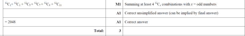

i. A plate of cake holds ##12## different cakes. Find the number of ways these cakes can be shared between Alex and James if each receives an odd number of cakes.

I went through the question; find the mark scheme here;
Well i can follow the mark scheme steps but i need some clarity or rather insight. The ##12## cakes are being shared to the two persons. In my understanding the odd numbers are;
##[1,3,5,7,9,11]## Now this means that they may each get ##1## cake in ##1 ×11C_1## ways or alternatively ##^{12}C_1×2##persons...
...are they not supposed to have ##2048 ×2##?
Supposing it was ##13## people instead of ##2## ...Would the steps still be the same as shown on the markscheme? A bit confusing...
your insight appreciated...

My understanding (which is consistent with the mark scheme) is that they can't each get one cake: If Alex gets one cake then James gets the remaining 11. There are [itex]{}^{12}C_{1} = {}^{12}C_{11} = 12[/itex] ways to achieve this.
Ok, that's clear now, maybe i was not interpreting the language correctly... :cool:
... I get it now [itex]{}^{12}C_{3} = {}^{12}C_{9} = 220[/itex] ways ...

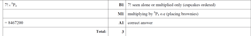

This is the second part of the question; i do not seem to get it.
ii. Another plate holds ##7## cup cakes, each with a different colour icing, and ##4## Brownies, each of a different size. Find the number of different ways these ##11## cakes can be arranged in a row if no Brownie is next to another Brownie.
Find the solution here;
In my understanding, they clamped the Brownies together i.e
1234567Brownie
Its clear to me that the ##7## cup cakes can be arranged in ##7!## ways no problem there... now when it come to the Brownies, i do not seem to understand the ##^8P_4## ways. Does the ##4## apply to Brownies only or all....
Unless the reasoning is like this;
BBBB
but each cell having the Brownie can arranged in ##4!# ways...secondly supposing we amend the question to all Brownies have to be next to each other, then how would this look like?
cheers
My other reasoning on this; since we do not want the brownies to be next to each other then the only possibility would be to have barriers in between i.e the cup cakes, that is;
BCBCBCBC
The cup cakes can be arranged like earlier stated in ##7!## ways...In whichever way we arrange them it does not matter as long as their sum total (cup cakes) =7.
For e.g;
B4Cup CakesBCBCBC
or
B2 Cup cakesB1 CupcakeB3 Cup cakesB1 Cupcake
Now we have ##8## elements implying that the brownies can be arranged in ##^8P_4## ways...giving us the desired; ##7! ×^8P_4=8467200## ways.
Cheers! Bingo!
