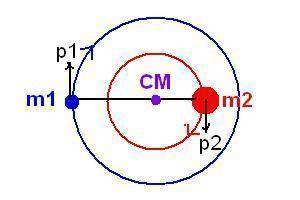

A binary star system consists of a star P and a star Q, of mass 4.0 x 10^10 kg and 2.0 x 10^10 kg respectively, separated 6.3 x 10^9 m apart. Star P and Star Q move in circular orbits with their centers at the center of mass which remains at rest.
Find the position of the center of mass of the binary star system.

The position of the center of mass is independent of all forces that act, it depends only on the masses and their positions. Your teacher used momentums to find a point with respect to the sum of the momentums is zero:
m1v1+m2v2=0.
Both stars orbit along concentric circles so as the straight line connecting them goes through the common center of the circles (the center of mass, CM) and their angular velocities are the same, ω. The total momentum of the binary star system is zero. See the figure: when one star moves up, the other down, so the direction of their momentums are opposite. If m1 is at distance r1 from the center and m2 is at distance r2, the velocities are
v1=m1r1ω and
v2=-m1r1ω .
The total momentum is
m1v1+m2v2=0, that is
m1r1ω -m1r1ω =0
m1r1=m2r2. *
You are given the distance between the stars,
d=r1+r2. **
Find r1 and r2
from equations * and **.
