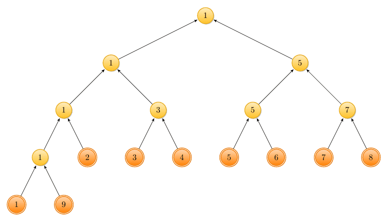

For $n=9$, we have, for example, this tournament tree, right?
Why is it a complete binary tree, but not a full one? (Thinking)
It is neither, because node $\enclose{circle}9$ is really at level 2 instead of on the last level. :eek:
The complete binary tree is:
And it's not a full binary tree since the last level is not fully occupied. (Shake)

I may have gone overboard when creating the tree. (Blush)
It's not supposed to be sorted.
It was just easiest to do it that way.
We just need to slide element $(n+1)$ in somewhere so that we still have a complete binary tree.
That is always possible and will take exactly $1$ more comparison to figure out number one.

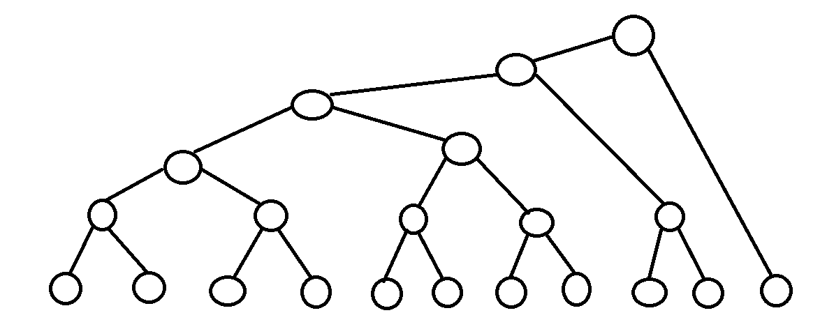

I thought that it would be like that:
So, is it wrong? (Thinking) Do we have to put the first $2^3=8$ elements at the same level and the remaining $11-8=3$ elements at the next level? :confused: :confused:
I like Serena said:
Not really. We can shuffle the leaves around any way we like. (Dance)
How could we do it otherwise? (Worried)

    With one more comparison, we can find which of these two elements is smaller.
    In total, we needed:
    $$m + (m + \lceil \lg{m}\rceil - 2) + 1 = 2m + \lceil \lg{m} + 1\rceil -2 = n + \lceil \lg{n}\rceil - 2$$
    comparisons.
  • Similarly, if $n=2m+1$, we split the elements into $m$ pairs and we leave an element alone .
    After $m$ comparisons, we have the smallest $m$ elements and the one that we have left alone , and then with $(m+1) + \lceil \lg{(m+1)}\rceil - 2$ comparisons , we find the smallest and the second smallest from the $m+1$ elements.
    Finally, with at most one comparison we find the smallest and the second smallest element of the initial set of numbers. In total, we needed
    $$m + (m+1 + \lceil \lg{(m+1)}\rceil - 2) + 1 = 2m+1 + \lceil \lg{(m+1)} + 1\rceil -2 \\ = n+ \lceil \lg { \left ( \frac{2m+2}{2}\right )+1 \rceil}-2=n+ \lceil \lg { (2m+2} ) \rceil-2= n+ \lceil \lg { (n+1} ) \rceil-2$$
    comparisons.
Is it right so far? Also, how can I show that $n+ \lceil \lg { (n+1} ) \rceil-2$ is equal to $n+ \lceil \lg { n} \rceil-2$ ? (Thinking)
