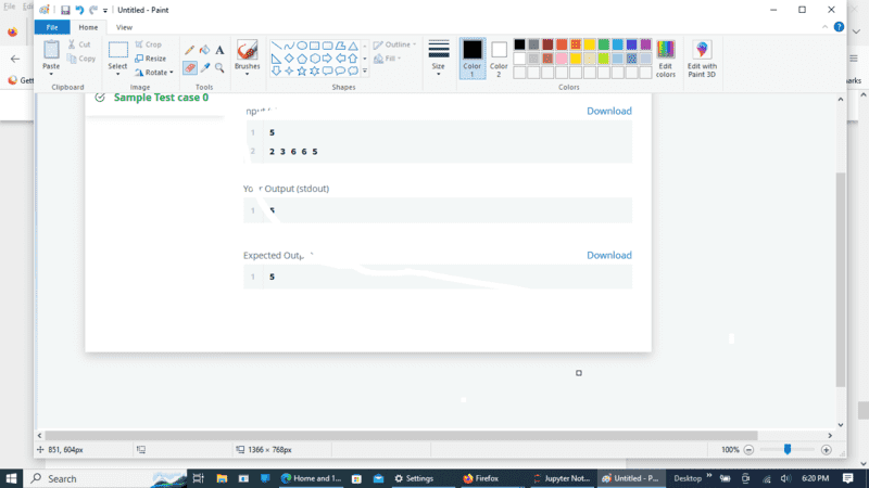

Sorry, I just was able to use my paint to copy the output of the HR run:
u
So the issue is how to enter the input as you did, but it doesn't seem to give me that option. Let me retry.

Thanks, @pbuk ,all, you were right all along. Egg on my face :(
First the missing () .
After fixing, I was indeed prompted to succesively enter two 1-line inputs. Second
was to be entered with spacing, as in:
2 3 4 5 2
" Mystery" (carelessness) solved. Sorry.
Thanks to all.

This is a HackerRank problem and the format of the input (a string of numbers with spaces in between) is part of the specification (the HackerRank backend presumably directs its test cases via stdin).
pbuk said:
Your solution does not deal with duplicates in the manner specified in the problem
In reply to both of the above, I didn't see the problem description as shown on HackerRank.
