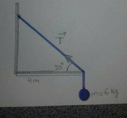

Construction is in balance. The weight of the hanging body is 6 kg. The angle created between the wire and the wall is 30 degrees.
Find the thread tension in the construction shown in the figure.
I do not understand how this type of exercise is solved because I have not had a solution to such an example. I would ask you to show me the solution of this exercise step by step, so that I understand how to solve it. I appreciate your help. Thank you.
besi said:
Homework Statement:: Construction is in balance. The weight of the hanging body is 6 kg. The angle created between the wire and the wall is 30 degrees.
Relevant Equations:: Find the thread tension in the construction shown in the figure.
Hi besi. The forum rules require you to make some sort of attempt first. Take a look:
https://www.physicsforums.com/threads/homework-help-guidelines-for-students-and-helpers.686781/
Please note, you say “The angle created between the wire and the wall is 30 degrees”. But your diagram indicates this angle is 90º – 20º = 70º. So something is wrong!
The simplest method requires you to know how to resolve a vector into components If you don’t know how to do this already, you could try this video (sorry about the self-promotion!):
Then maybe you can make an attempt at the problem.

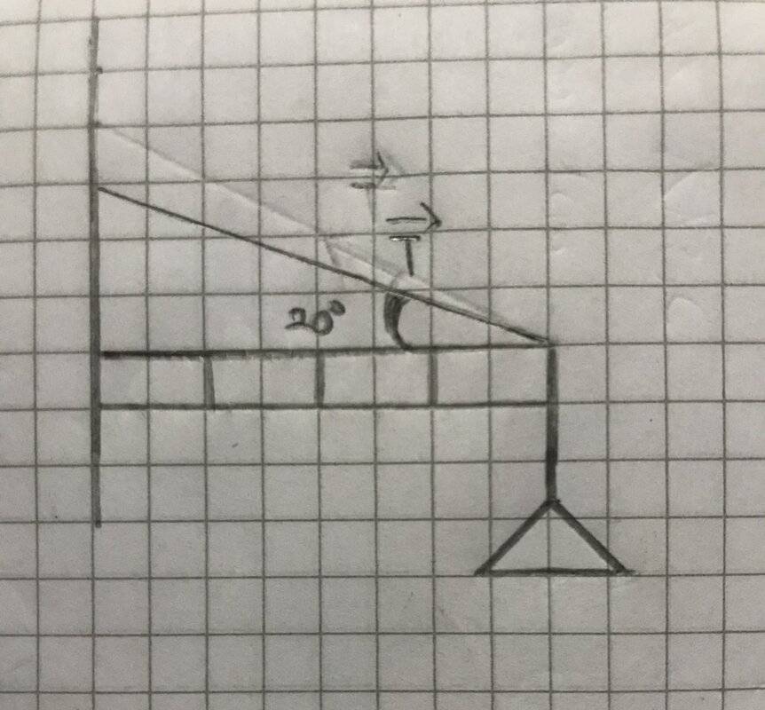

Hello! My physics professor gave us this kind of exercise but i couldn’t solve it. Please who can help me solve it. Construction is in balance. The weight of the hanging body is 6 kg. The angle is 20°
Hannah, much depends upon how the beam is attached to the wall. Is it embedded in the wall, or is it pivoted at the wall?
Do you know how to draw a free body diagram (FBD)?
I think is embedded in the wall. Not sure but it’s exactly like the besi’s type of exercise
Yes, it is exactly the same, even in that it is not made clear whether the joint at the wall
  • is rigid, in which case we must assume the string is free to slide over the other end of the beam in order to be able to solve it, or
  • is a pivot, in which case the string must be tied to the end of the beam or it would collapse
In each diagram, it looks rigid, so let's go with that. So the string is free to slide.
Consider the forces acting along the string as it goes around the end of the beam. Since it does not slide, what can you deduce?

I think T might be cos20°+d but I’m not sure. I really need the answer of this exercise. Do u know it? Please
As I mentioned, forum rules require you to show more effort.
Why do you think it might be cos20°+d, and what is d?
Oh, I should have mentioned two more things.
  1. With the rigid joint assumption you will also need to assume the edge of the beam where the string slides is smooth.
  2. Although I have recommended to go with the rigid joint assumption based on the drawings, in every other problem like this I have ever seen posted on this forum, the string is tied to the end of the beam and the beam is pivoted at the wall. Should I trust these drawings? They are not from the teacher.

d is the 4 m. The drawings are from the teacher but the problem is that I can’t solve it 😅. Also I can I show more effort?
Ok, we'll stick with the rigid joint then.
As I wrote, take the end of the beam the string slides over as smooth. So you can think of it as a pulley.
Do you know how to take moments about an axis?

As I wrote, you can think of the string as running over a pulley at the end of the beam.
There are two tensions in the string, T pulling anticlockwise and the weight pulling clockwise. The 'pulley' doesn’t spin. What does that tell you?
This means that the construction is in balance. T + P = 0
P = mg
that's all i can do

You are very close.
The sum of the moments is zero, but they act in opposite directions. So what equation relates the tensions?
haruspex said:
You are very close.
I think I would be T= 60N + 4*sin30°
I don’t know if it’s right , so please can u tell me the answer if u know it . 😢
That makes no sense. 4m sin 30 would be a distance. You cannot add a distance to a force.
As I posted, you were very close before. Please don't go off in some other direction.
The two torques balance, but your equation in post #17 would make one of the tensions negative.
The tensions are both positive. They balance because they act in opposite directions around the 'pulley'. So what should your equation be?
