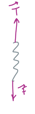

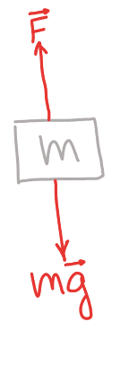

Then I draw the free body diagram for both the mass and for the spring, here's where I don't know if what I did was right:
Where $$\vec{F}$$ is the elastic force
The equations I get are $$F=mg$$ and $$T=F$$ (because at that moment $$\vec{a}=0$$ ?)and this is where starts my confusion:
If I only use those two equations, I get that $$T=mg$$ BUT if I take into account the energy equation, I get that $$F=kh=2mg$$, and then $$T=2mg$$.
What would be the correct way to solve this problem? I'm really confused with the equations I got...

I believe that your confusion started when assuming that ##F=mg## for height=0 in your diagram.
Rather, that force should be ##F=ma##.
The mass is experiencing two similar and mirroring conditions at both height=h and height=0: zero kinetic energy and maximum potential energy.
Maximum potential gravitational energy belongs to height=h.
Maximum potential elastic energy belongs to height=0.
There is a midpoint along that height at which all potential energy has become kinetic energy.
Because the mass has reached its highest velocity at that point, it can’t stop there.
The spring is still not acting on the mass at height=h; therefore, ##F=mg## is the only force inducing a downwards acceleration at that point.
The maximum value of the rope tension must be greater than mg for the mass to be stopped at height=0 and accelerated upwards again at same rate, in such way that a simple harmonic up-down motion is established.
##F\neq mg## because you didn't take the acceleration into consideration. The correct answer, in my opinion, is ##F-mg=ma##. Also, the acceleration of the mass is not 0, which was pointed out by Tsny.
