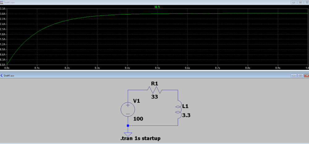

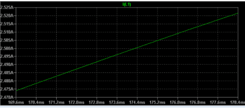

what is the equation on finding the ''The time required for the current to grow to ...Amps''
i was asked to find The time required for the current to grow to 2.5Amps ,and i found out that its some where around 174.38ms, using Ltspice, but i want to find it out by calculating it out.
According to our rules, to get homework help, you need to post an attempt at a solution. Please state the problem, post any relevant diagrams and show your attempt.
Q)A coil having a resistance of 33Ω and an inductance of 3.3H is connected across a 100V d.c. supply. Plot a graph of the current as a function of time using LTspice.
a)The time required for the current to grow to 2.5A
i found that its around 174ms , but i also need to find it by calculating it ,but i don't know how .

i also forgot to add , i have attempted to try it and i did 3.03(1-e^33/3.3) is that any where close ? or is this completely different equation just wanted to check

i=v/r(1-e^-(R/L)t) ,and i haven't learn the differential equation for the Voltage and Current yet

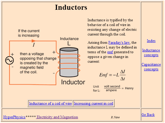

The equation relating voltage and current in an inductor is:
$$v(t) = L\frac{di(t)}{dt}$$
http://hyperphysics.phy-astr.gsu.edu/hbase/electric/induct.html

so basically that's the formula I've used ,and when you say what is the difference between r and R in that equation what do you mean by that , sorry am kind of new to all the physics part ,

Its final value would be 3.03A because 100V/33R
That looks a lot better! Can you use the simulator (does it have markers you can move along the waveform?) to answer the question about the time to 2.5A? And can you solve the exponential equation to verify that same time? :smile:
