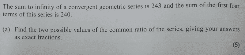

See attached.
sequences
*kindly note that i do not have the solutions ...I was looking at this, not quite sure on what they mean by exact fractions, anyway my approach is as follows;
##\dfrac {a}{243}=\dfrac{a(1-r^3)}{240}##
##\dfrac {1}{243}=\dfrac{1-r^3}{240}##
##\dfrac {240}{243}=1-r^3##
##r^3=1-\dfrac{240}{243}##
##r^3=\dfrac{3}{243}##
##r=\dfrac{1}{\sqrt [3]81}=\dfrac{1}{3\sqrt [3]3}##
My alternative approach,
##(243-243r)(1-r^3)=240-240r##
##243r^4-243r^3-3r+3=0## using ti- nspire i realized same value as first approach...
I am not sure of my answer, I will need to check the r value and see whether i will realize the sum of ##240##. On quick checking i seem to have the correct terms i.e ##[184.4..., 43.6333..., 9.85468..., 2.2813...]## whose ##S_{4}≅240.##
I think i got it...let me post my working...:cool:

Does that mean my approach is wrong? Is my ##r_2## correct? Of course, we only have one ##r## value that will satisfy our problem. Thanks @anuttarasammyak
Exact fraction: 1/3
Not exact fraction: .333
IOW, not numbers like 9.85468...
I believe you're off here. The numerator on the right side should be ##a(1 - r^4)##. If you fix that error, you get what @anuttarasammyak got, ##r^2 = \frac 1 9##, which has two solutions.

silly me...was fixated on using nth term formula ...##r^{n-1}## instead of sum... ##r^n##...i did this in a rush...cheers Mark.

...I ought to have,
##\dfrac {a}{243}=\dfrac{a(1-r^4)}{240}##
...##r^2=\dfrac{1}{9}##
##r_1=\dfrac{1}{3}## and ##r_2=-\dfrac{1}{3}##
Be sure to check these, if you haven't done so already.
