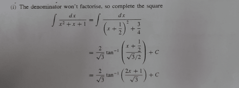

see attached
##\dfrac{d}{dx} \left[\tan^{-1}x\right]= \dfrac{1}{x^2+1}##
Now the steps to solution are clear to me...My interest is on the constant that was factored out i.e ##\frac{2}{\sqrt 3}##...
Handwritten working for the integral of dx over x squared plus x plus 1, completing the square to (x + 1/2) squared plus 3/4, giving 2/sqrt(3) arctan((x + 1/2)/(sqrt(3)/2)) + C, then 2/sqrt(3) arctan((2x + 1)/sqrt(3)) + C.
the steps that were followed are; They multiplied each term by ##\dfrac{2}{\sqrt 3}## to realize,
##\dfrac{2}{\sqrt 3}\int \dfrac{dx}{\left[\dfrac{2}{\sqrt 3}⋅\dfrac{2x+1}{2}\right]^2+\left[\dfrac{2}{\sqrt 3}⋅\dfrac{\sqrt 3}{2}\right]^2} ##
Correct? Is there a different approach guys?
Now, bringing me to my question...see problem below;
Handwritten derivation of the integral of dx over the square root of 3 minus 2x minus x squared, completing the square to 4 minus (x+1) squared, then substituting u = x+1 to reach the result sin inverse of (x+1)/2 plus C.
Are they missing ##\dfrac{1}{2}## somewhere?? In this case we are dividing each term by ##2^2##... we ought to have;
... ##\dfrac{1}{2}\sin^{-1} \left[\frac{x+1}{2}\right] + c##
I hope i did not overlook anything...
[tex] \int \frac{1}{\sqrt{2^2 - (x + 1)^2}}\,dx = \int \frac{1}{2\sqrt{1 - u^2}}(2\,du)[/tex] with [itex]u = (x + 1)/2[/itex].
Thanks ...cheers man!
Aaaargh! because of the square root sign! That calls for 'change of variable' ...was wondering why...great day!
