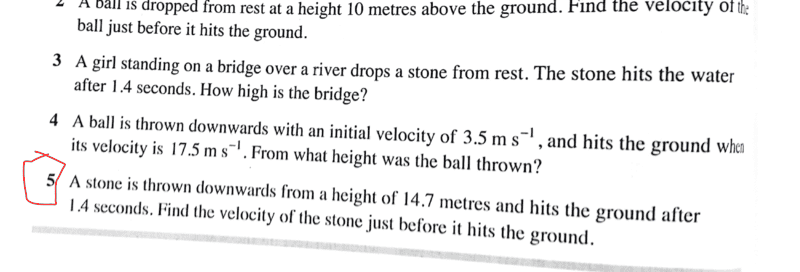

Find the velocity of the stone just before it hits the ground

Highlighted question in Red.
Question.5
Mechanics
In my lines i have,
##h(t)=ut+\dfrac{1}{2}at^2## where ##u=0##,
with ##a=10##,
##h = \dfrac{1}{2}×10t^2## ....................1
...also,
##h-14.7 = \dfrac{1}{2}×10 (1.4-t)^2## ..................2
1- 2 gives,
##14.7 = 14t -9.8##
##24.5=14t##
##t=1.75##
Therefore, ##v = 10× 1.75=17.5## m/s , with ##u=0##.
correct? Cheers

If by "u" you mean initial speed, it is not zero. The stone is "thrown downwards".

What is ##h## in the equation you wrote ##~h-14.7 = \dfrac{1}{2}×10 (1.4-t)^2~?##
Hmm ##\dots## Let's see.
At ##~t=0##, ##h=(14.7+\dfrac{1}{2}\times 10\times 1.4)~\text{m}=21.7~\text{m}.##
At ##~t=1.4~\text{s}##, ##h=14.7~\text{m}.##
This doesn't match what is given.

It's the final velocity who is 17.5 m/s and not the initial. The question asks for the final velocity (when it hits the ground). vo is about 3.5 m/s.

The average velocity is ##10.5m/s##, which would be at ##t = 0.7s##. So, initial velocity is ##3.5m/s## and final velocity ##17.5 m/s##.

Just to redeem myself, another way to approach this problem is to use the SUVAT equation with the final velocity replacing the initial velocity, $$h=h_0+v_f~t-\frac{1}{2}at^2.$$Of course here ##a=-g##.

In my reasoning, in reference to my initial velocity being ##0##, the person throwing the stone had the clock ticking for some time (stone still on his hands),that is for##1.75-1.4## seconds before throwing ball ... that landed ##1.4## seconds later on the ground... that was my reasoning and it looks like it isn't correct.

Boss I was wondering how you got the ##u = 3.5##m/s.
arrrggh I see that...
From
##14.7 = 1.4u +9.8##
Which means,
##v^2= 3.5^2 + (2 •10•14.7)##
##v^2 = 306.15##
##v= 17.5##
Cheers man!
