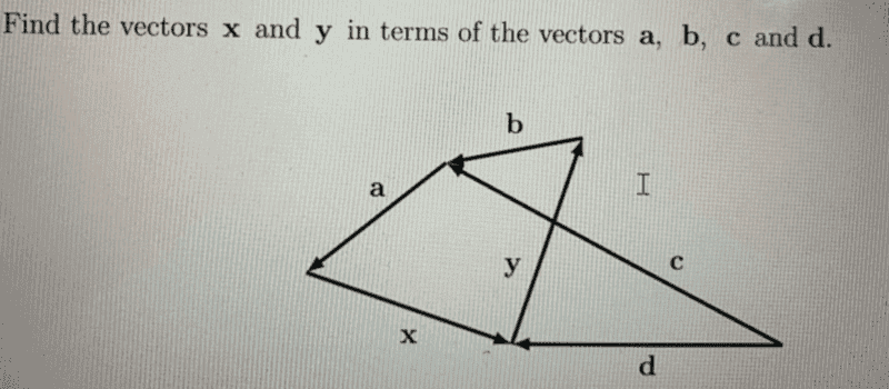

This is the problem,
Vector diagram with a quadrilateral-like figure of arrows labelled a, b, c, d, x and y, with the instruction to find x and y in terms of a, b, c and d.
I managed to solve it, i just want to check if there is an alternative approach. Find my solution below;
##\vec x= -\vec a-\vec b-\vec y##
##\vec y= -\vec d+\vec c-\vec b## therefore,
##\vec x= -\vec a-\vec b+\vec d-\vec c+\vec b##
##\vec x= -\vec a+\vec d-\vec c##

You could improve the solution slightly by using a different loop to find ##\vec x##.
Can you see the loop containing ##\vec x## but not contianing ##\vec y##?

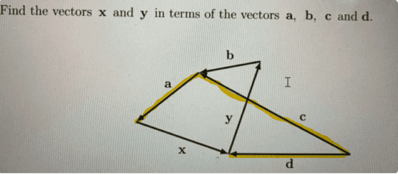

It would just be direct from the diagram...
Yes. It doesn't save much work in this particular problem, but it's still a good idea to look for the 'best' loop(s).
