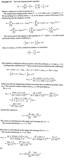

I'm following the method used in the textbook mathematics for physicist by lea.
Here's the example I'm following. Maybe you'll understand what I'm trying to do.
If I'm correct I found the recursion relation and then I plugged p = 3/2.
