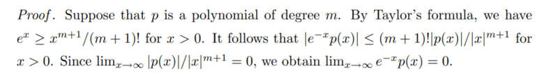

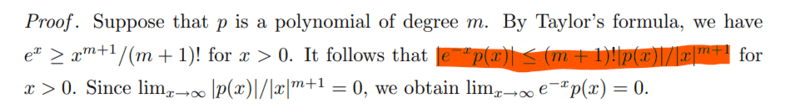

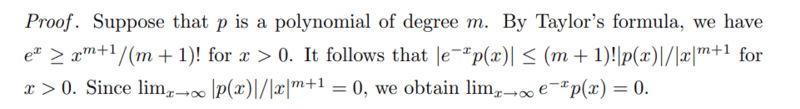

Thank you for your replies @fresh_42 and @WWGD!
For a non-proof by induction, I think we can use Taylors theorem:
Printed proof text: Suppose p is a polynomial of degree m. By Taylor's formula e^x >= x^(m+1)/(m+1)! for x > 0, so |e^(-x) p(x)| <= (m+1)! |p(x)|/|x|^(m+1) for x > 0, highlighted in orange. Since the limit as x goes to infinity of |p(x)|/|x|^(m+1) is 0, the limit of e^(-x) p(x) is 0.
I would insert a step about using taking the limit of the highlighted inequality. SOmething like ##\lim_{x \to \infty} \frac{P(x)}{e^x} \leq \lim_{x \to \infty} \frac{(n + 1)! |P(x)|}{|x|^{n + 1}} = 0##
Apart from that does anybody else agree that this is an elegant and simple version of the proof?
Thanks!

Yes, a direct proof at this level is usually shorter and more concise than a proof by induction, and so I think it's better.
