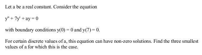

Finding a constant that makes the differential equation hold
7 replies · 2K views · last reply
s3a
828
I get a = -49/4, 0, 49/4 by using the characteristic equation and quadratic formula and searching for values of a inside of the square root for which a is 0 or greater which isn't correct apparently. I've also wondered if the inside of the root should be less than 0 such that I can get a solution involving complex numbers using natural exponents which could lead me to the trigonometry involving reals but I don't have any concrete plans on getting this to work if this is what I am supposed to do.
Any help would be greatly appreciated!
Thanks in advance!
Edit: Added the question.
