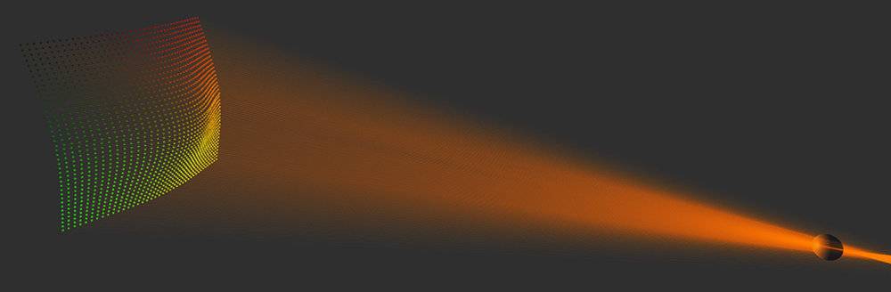

The vector field represents what the normal should be at any point so that a refracted ray of light focuses on a given point
I've managed to integrate the gradient at a given depth within the field, which gives a height map
Integration technique https://math.stackexchange.com/ques...ically-calculate-a-function-from-its-gradient
Look at this beauty ❤

I wonder if you can extend the idea of integral curves to integral surfaces, or maybe Morse theory somehow?
I'm sure that integral curves can be applied to integral surfaces given that a surface is just a collection of curves, in the same way a curve is just a collection of points. As for the Morse theory, I'm not familiar with it, but as far as I understand it's mainly used for reconstructing a surface, whereas I needed to find some valid points within a vector field. I guess it could be applied when discretizing the field, in order to generate more accurate, but also messier topology as opposed to sampling on a grid.
