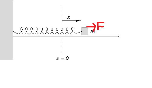

A man applies a Force F on a spring block system shown.towards right when the block is at rest and spring is relaxed .If F is constant then
[/B]
: F=-kx[/B]
The equilibrium position will be at the position where the disturbing and restoring fores are equal
F=kx
x=F/k
Also the time period will be 2pi√m/k.How should I proceed after this

What is the problem asking you to find?
The Amplitude of the resulting simple harmonic motion

What is the initial position of the block with rspect to the new equilibrium point?

The intial position of the block is at the point where the spring is relaxed
If the force applied is constant, as stated, then the equilibrium position is where the applied force ##F_{a}## is equal to the force from the spring ##F_{s}##.
##F_{a}=F_{s}=kx##
You just need to solve for ##x##.
Yes, and it will perform SHM about the new equilibrium point. At t=0, what is its displacement with respect to that point?
F/k in my opinion
F/k in my opinion
Yes. Write the time dependence of the displacement of the box for t ≥ 0.

The block is at rest and the spring is relaxed initially. So you know the position and velocity at t =0. No need for the velocity at the new equilibrium.
The equation of displacement will be :X=Asin( ωt+ Φ). At t=0, F/k=Asin( Φ).

You said the block is at rest at this point...won't this mean this is the amplitude point because at amplitude velocity is zero?
Yes, the displacement of the block from its new equilibrium is biggest at t=0, when it is in rest. And the biggest displacement from equilibrium is the amplitude.
