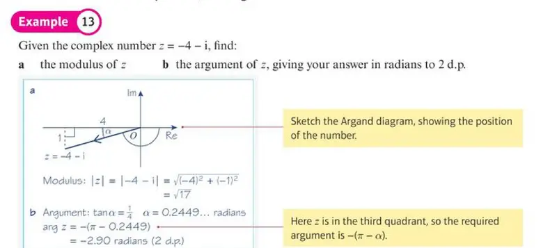

See attached.
Complex numbers
I am going through this,quite straightforward ...just some bit of clarity from your end; the textbook indicates, the argument as ##-2.90## i have no problem with that as tan cycles at every ##\pi## radians. The problem is that i am not used to this approach.
My approach is more straightforward i.e
##\tan \alpha= 0.25##
##\alpha= \tan^{-1} 0.24 = 0.2449##
##\alpha_{required angle}= \pi + 0.2449=3.386=3.39 ##(2 dp) My question is' does it matter or there is a systematic approach to this; are both approaches valid. Of course, i can see that going backwards ( in terms of cycle) ##[3.386-\pi]=[0.244-\pi]=-2.8971##
Thanks.
or to answer my own question, it depends on the domain given.
Worked example from a textbook: Argand diagram of z = -4 - i with modulus 4 and 1 marked, angle alpha at origin, and modulus |z| = sqrt(17); argument calculation tan alpha = 1/4, alpha = 0.2449 radians, arg z = -(pi - 0.2449) = -2.90 radians.
Angles are usually measured counterclockwise from the positive real axis, so I would favor your answer, which is ##\pi + \alpha \approx 3.39##.
Of course, if the goal was to calculate the angle indicated by O in the drawing, then I would favor the answer they showed.
It depends on the branch. Here the book appears to be assuming [itex]-\pi < \arg z \leq \pi[/itex], which is the standard branch.

The standard branch −π<arg⁡z≤π is a principal branch of arg⁡z.
The solutions of arg⁡z, for which the arg⁡z value lies between −π<arg⁡z≤π, are called the principal values of arg⁡z.
