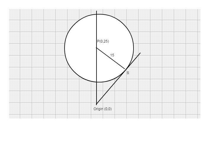

A geometrical approach would also work, but I don't want to distract you if you don't need another approach.
Take the tangent from the origin to the circle centered at ##25i## with radius 15 (the tangent with positive slope, as we want the lowest positive argument). The point you need is the intersection of the tangent and the circle.
This will easily give you r, and, from there you get ##\phi##.

So ##z=12 + 16i##.
You are looking for the point ##z## that satisfies ##|z-25i| \leq 15## and with the lowest possible argument.
##z## has to be in (or on) the circle with centre at (0,25) and with radius 15.
You will get the lowest argument with the tangent from the origin to the circle. That gives you the point S (or ##z## as complex number). As POS is a right triangle, you easily get that r=20.
And then you can compute ##\arcsin \phi## from the same triangle POS.
(Sorry for the clumsy drawing, never used that whiteboard before. P is supposed to be the centre of the circle.:smile:)
Keep in mind that |z - 25i| represents the distance from a complex number z to the complex number 25i. You should be able to solve this problem simply by drawing a diagram.
