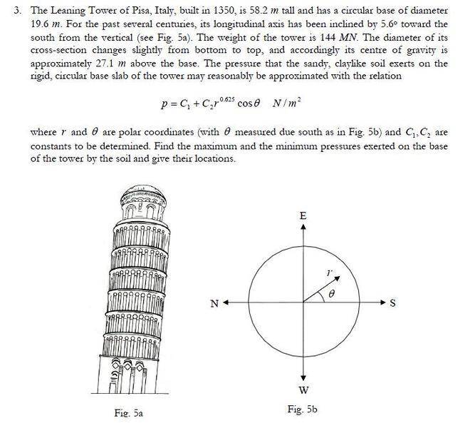

The problem is as attached.
I tried doing double integration of r from 0 to 9.8 and θ from 0 to 2pi. But here I am assuming all forces from the soil act along the tower (no friction) and managed to solve C1.
But I am not sure how to solve C2?
It helps if you show us how you have been trying.
Can you not find the max and min locations without knowing C2?
voko said:
What are the equilibrium conditions?
1) Vector Sum of forces about any direction = 0
2)no resultant moment about any point
That should give you two somewhat different integrals, hence you should be able to determine the two constants from them.
Yes, but the cos θ becomes sin θ and then from 0 to 2∏ it cancels out to be zero..

Here's what I got:
Let infinitesimal moment be dM.
∫ dM = ∫ r dF = ∫ rP dA = ∫∫ r2P dr dθ...
Then when ∫cosθ becomes sin θ the limits going from 0 to 2∏ it becomes 0, so C2 cannot be found..
Observe how the second term of pressure behaves. Its moment about O must be non-zero.
Like I said, this cannot be zero. The specific mistake you are making is that of ignoring the vector nature of r and F. What you denote as dM is a vector product of r and dF. Work it out.
yes, dM = r x F
but I assumed all F acts upwards, so vectors r and F are perpendicular so it simply becomes r*F...
Draw the resultant moment in a few different places and you will see different directions. You can't add them together as scalars.
That is true...I realized that only for the same angle they are pointing in the same direction
So how do we find the net moment? It's like trying to sum up all the vectors in different directions..
Expand the vectors involved in terms of the coordinate unit vectors i, j, k. Do the vector product. What do you get?
d[itex]\overline{M}[/itex]
= [itex]\overline{r}[/itex] x d[itex]\overline{F}[/itex]
= ([itex]\overline{r}[/itex] x [itex]\overline{p}[/itex]) dA
= (r cosθ [itex]\widehat{i}[/itex] + r sinθ [itex]\widehat{j}[/itex]) x (C1 + C2 r0.625 cosθ)[itex]\widehat{k}[/itex]
= -( C1 cosθ + C2 r1.625 cos2θ) [itex]\widehat{j}[/itex] + (C1 r sinθ + C2 r1.625 sinθcosθ ) [itex]\widehat{i}[/itex]
Along j
[itex]\int[/itex] d[itex]\overline{M}[/itex]
= - [itex]\int[/itex][itex]^{9.8}_{0}[/itex] dr [itex]\int[/itex][itex]^{2∏}_{0}[/itex] dθ [C1 r cosθ + C2 r1.625 cos2θ]
= -478.9 C2
Along j
Everything cancels out to be zero!

So, have you solved the entire problem?
I found C1 and C2;
C1 = 477 300
C2 = 799 832
which gives:
pmin = -2853243
pmax = 3807843
How can there be negative pressure? It doesn't make any sense... (Given the initial assumption that all forces act upwards)
Your answers are obviously incorrect, pressure cannot be negative. I guess the equation of forces or torques is incorrect.
I can't see what's wrong with my equations for torque?
But here's what I used for my force equations:
dF = p dA
dA = r dr dθ
[itex]\int[/itex] dF
= [itex]\int[/itex][itex]\int[/itex] pr dr dθ
= [itex]\int[/itex][itex]^{9.8}_{0}[/itex] dr [itex]\int[/itex][itex]^{2∏}_{0}[/itex] dθ [C1r + C2r1.625 cosθ ]
= 2∏ [itex]\int[/itex][itex]^{9.8}_{0}[/itex] dr [C1r]
= (9.8)2 ∏ C1
= 301.7 C1Sum of forces in z-direction must be zero:
301.7 C1 = 144*106
C1 = 477 300Not sure what's wrong here...
My assumptions are:
1) All forces ground acting on base are upwards (z-direction)
First of all, you are ignoring that the base slab is inclined. So the total force of pressure is different from the total weight.
Secondly, in the torque integral I think you did not express the area element correctly.
Thirdly, since you have not shown the torque equation, I can't say much else :)
Ok, given that the slab is inclined at 5.6 degrees, we can simply take the answer * cos 5.6 but it would roughly give the same answer..
I'm not sure where I went wrong for my torque equation:
= ([itex]\bar{r}[/itex] x [itex]\bar{F}[/itex])
= ([itex]\bar{r}[/itex] x [itex]\bar{p}[/itex]) dA
The area element must include r, which it does not. That makes the integral on order of magnitude smaller than it should be, and the constant, consequently, an order of magnitude greater.
Bearing in mind what you said, I reworked everything out and here's what I got:
C1 = 480 000 (Very nice number, I know)
C2 = 113 325
This gives:
Pmin = 8109
Pmax = 951 891
Assume: [itex]\bar{P}[/itex] acts along tower
[itex]\bar{P}[/itex] = ( C1 + C2r0.625 cosθ )cos5.6o [itex]\hat{k}[/itex] + ( C1 +C2r0.625 cosθ )sin 5.6o ) [itex]\hat{i}[/itex]We know vector sum of forces along [itex]\hat{k}[/itex] must be equal to 0.
We first find the contribution by the soil:
Along k
dF = ( C1 + C2r0.625 cosθ)cos 5.6o r*dθ dr[itex]\int[/itex] dF = cos 5.6o [itex]\int[/itex][itex]^{9.8}_{0}[/itex] dr [itex]\int[/itex][itex]^{2π}_{0}[/itex] dθ [C1 r + C2r1.625 cosθ ]
= 300C1
300C1 = 144*106
C1 = 480000
Finding C2
d[itex]\bar{M}[/itex]
= [itex]\bar{r}[/itex] x d[itex]\bar{F}[/itex]
= [itex]\bar{r}[/itex] x [itex]\bar{P}[/itex]dA
= [r cosθ [itex]\hat{i}[/itex] + r sinθ [itex]\hat{j}[/itex]] x [ (C1+C2r0.625cosθ)cos5.6o [itex]\hat{k}[/itex] + (C1+C2r0.625cosθ)sin5.6o [itex]\hat{i}[/itex]] (r*dr dθ)
Then you find when you integrate dθ from 0 to 2∏ components along [itex]\hat{i}[/itex] and [itex]\hat{k}[/itex] turn out to be 0.
Thus the only contribution is along [itex]\hat{j}[/itex]
-cos 5.6o [itex]\int[/itex][itex]^{9.8}_{0}[/itex] dr [itex]\int[/itex][itex]^{2π}_{0}[/itex] dθ [C1r2cosθ + C2r2.625cos2θ]
=-3380 C2
Thus,
3380 C2 = (144*106)(27.1 * sin 5.6o)
C2 = 113 325
I just realized my answer is more accurate than the one provided by the tutor! (The tutor assumed P acts only directly upwards in the z-direction...)

Explain why you have cos 5.6 in front of both integrals. That does not seem correct to me.
