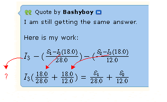

Here is my work:
[itex]I_3 - (\frac{\mathcal{E}_1 - I_3(18.0)}{28.0}) - (\frac{\mathcal{E}_2 -I_3(18.0)}{12.0}[/itex]
[itex]I_3(\frac{18.0}{28.0} + \frac{18.0}{12.0}) = \frac{\mathcal{E}_1}{28.0} + \frac{\mathcal{E}_2}{12.0}[/itex]

What about the "lone" I3 term on the left? Why did it disappear?
What lone I3 term? I didn't intend for any to disappear.

Once I got to this step, I divided both sides by [itex]\frac{18.0}{28.0} + \frac{18.0}{12.0}[/itex]
Which gave me
Bashyboy said:
Finally,
[itex]I_3 = 0.872~A[/itex]
What happened to the first I3 term?
Screenshot of a forum quote showing handwritten-style algebra: I3 - (I1 - I3(18.0))/28.0 - (I2 - I3(18.0))/12.0 rewritten as I3(18.0/28.0 + 18.0/12.0) = I1/28.0 + I2/12.0, with red arrows and a question mark marking the first I3 term.
  • Screenshot of a forum quote by Bashyboy showing handwritten-style equations: I3 minus (I1 - I3(18.0))/28.0 minus (I2 - I3(18.0))/12.0, rewritten as I3(18.0/28.0 + 18.0/12.0) = I1/28.0 + I2/12.0, with red arrows and a question mark pointing to the I3 terms.
Oh, I see...It should be (1 + 18.0/28.0 + 18.0/12.0). I kept neglecting the 1.
