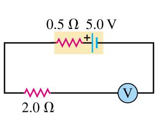

An ideal voltmeter is connected to a 2.0 Omega resistor and a battery with emf 5.0V and internal resistance 0.5 Omega
Series Circuit
V=IR
V=I(R1+R2)
R(total)=R1+R2
5.0V=I(.5 Ohms + 2.0 Ohms)
solve for I because current is conserved through a series circuit
I=2amps...this is wrong.
There is something very odd about this circuit. A voltmeter is designed to only let a tiny current (ideally just one electron per second) through in order to measure the energy per charge (Voltage). Thus practically no current will flow around the circuit.
It isn't a sensible question with the information given. Better check the question again. Incidentally, you didn't list any actual questions.
