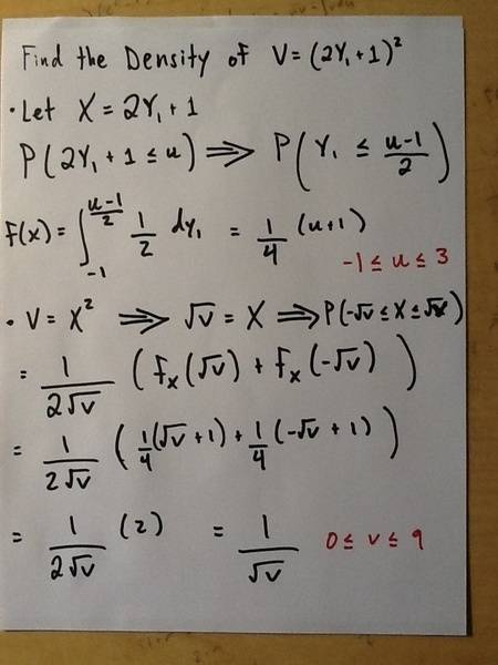

Suppose {Y1,...Yn} are random samples from U(-1,1) distribution. Find the density of V=(2Y1+1)^2
Method of transformations for random variables
I started this problem off by letting X=2Y1+1 because i figured i could find the density of that and then just find the density of V=X^2. I thought i had the problem right but when i went back to the density i got for X=2Y1+1 and integrated it over the interval, it didnt add up to 1. Not sure what i did wrong

Be careful about the range of the random variable. As Y1 ranges from -1 to +1, what is the range of 2Y1+1?
RGV
RGV
-1 to 3 right?
