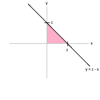

So I drew a picture (it still surprises me how helpful this is outside of physics class)...
Basically, I wanted to find the area shaded pink. I set my bounds...
##0\leq y \leq z - x##
##0 \leq x \leq z##
And I want to find ##P(X+Y\leq z)=P(Y\leq z - X)##. So...
##P(Y\leq z - X)=\int_0^z \int_0^{z-x} \frac{1}{2}(x+y)e^{-(x+y)}dydx##
Some substitution...
##u=(x+y)##, ##du=dy##
##z-x\mapsto z##, ##0\mapsto x##
So we have:
##P(Y\leq z - X)=\frac{1}{2} \int_0^z \int_x^z ue^{-u}dudx=\frac{1}{2} \int_0^z[-ue^{-u}-e^{-u}]|_x^z\\
=\frac{1}{2} \int_0^z [(-ze^{-z}-e^{-z})-(-xe^{-x}-e^{-x})]dx\\
=\frac{1}{2}(-ze^{-z}-e^{-z})x|_0^z+\frac{1}{2}\int_0^z (xe^{-x}+e^{-x})dx\\
=\frac{1}{2}(-z^2e^{-z}-ze^{-z})+\frac{1}{2}(-xe^{-x})|_0^z\\
=\frac{1}{2}(-z^2e^{-z}-2ze^{-z})=F_Z(z)##
Something's not right here. ##F_Z(z)## isn't supposed to be negative. I think I forgot to find the marginal of ##X## and integrate that along with the distribution function. On the other hand, I could set the upper bound for ##x## as ##z##, and use my original integrand to get the answer in the back of the book. But I cannot be sure that it's enough.

You are doing way too much work, as you already had the correct expression back in post #1:
$$f_Z(z) = \int_R f(x,z-x) \, dx.$$ However, you forgot that ##f=0## outside the region ##\{ x \geq 0, z-x \geq 0 \}##, and inside this region the integrand ##f(x,z-x) = ## a very simple function of ##z## alone.
As to where your error occurred: you computed ##\int_0^z (x e^{-x} + e^{-x} ) \, dx## incorrectly. Use ##\int_0^z e^{-x} \, dx = 1-e^{-z}## and ##\int_0^z x e^{-x} \, dx = 1 - (z+1) e^{-z}.##

Even easier and faster (following your post #1):
$$f_Z(z) = \int_{x=0}^z \underbrace{f(x,z-x)}_{(1/2) z e^{-z}} \, dx = (1/2) z^2 e^{-z}.$$
