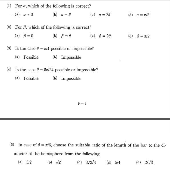

1. I think α = 90 because BD is normal force.
and I don't know anymore
Normal to what? What does that tell you about the geometry?

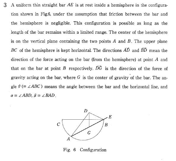

I think it is a normal force (from hemisphere) acting on the bar, so ABD which is angle of normal force should be 90 degree.

If I call a point (located at middle of BC) O, I think OA and OB are radius. Because OA and OB have same length so BAD = ABC. Is this correct?

AD and BD are normal force which are perpendicular to a tangent line of hemisphere. Therefore AO and BO are radius of the hemisphere.
Ah yes, I see. Except, BD is not perpendicular to the tangent. It is perpendicular to the rod.

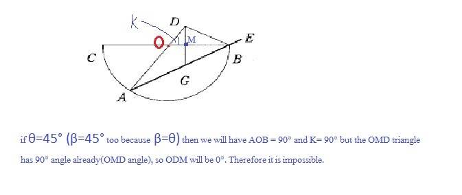

The key to this problem is this. Consider the point of intersection of segments AD and CE. What's special about it? Then either draw to-scale diagrams specific to each case as @haruspex suggested or derive a general expression for the ratio of the length to diameter in terms of angle ##\theta## and see what it is for each angle.
For the question3, I have found that if θ=45° (β=45° too because β=θ) this configuration is impossible.
Because we will have AOB = 90° and the nearby angle 90° (the angle of above triangle that is located on AD) but the above triangle has 90° angle already, so the other angle will be 0°. Therefore it is impossible.
Is this correct. Sorry for bad English again. I'm trying my best

You've lost me. Can you explain using the names of the points? Name some more points if necessary.
I'm trying to insert a picture, sorry.

thevinciz said:
I don't know
We have already established that BD is perpendicular to the rod. This means that triangle ABD is a right triangle with hypotenuse AD. How is AD related to the diameter of the circle? You may not be able to see what's going on unless you draw a good diagram as I have repeatedly suggested. The one provided to you appears to be deliberately misshapen perhaps so that nothing is given away. Try redrawing it, making the circle as round as possible and the perpendiculars as "perpendicular" as possible.
