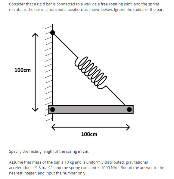

1.
// Tension of the spring
// Where sinL between `bottom right` of the spring and the bar
Ft = sinL * kx
// Where x0 is the initial length of the spring
Ft = sinL * k(x - x0)
// Force of gravity
Fg = -mg
// Find x0
// sqr = square root
x0 = sqr(100^2 + 100^2)
// Converted to meters
x0 = 1.421
Ft + Fg = 0
sinL * k(x - x0) - mg = 0
sinL * k(x - x0) = mg
1/1.421 * 1000(x - 1.421) = 10 * 9.8
(x - 1.421) = 98 / 1/1.421 * 1000
x - 1.421 = 98 / 703.73
x = 1.5602579540448752
// Converted to centimeters and rounded
x = 156cm
But for some reason this doesn't seem to be the right answer. ;(
If someone could help me would be really appreciated.
Thanks.

Dren said:
I meant x to be bigger than x0 after the rigid bar has been starching the spring.
The diagram shows the spring already stretched, with length ## \sqrt2~ m ## as you've found.
If the bar were removed, the spring would contract to its relaxed length. which must be ## < \sqrt2~ m ##
billy_joule said:
Yes.The diagram shows the spring already stretched, with length ## \sqrt2~ m ## as you've found.
I see, so I guess I was trying to solve the wrong problem from the beginning, so the question is: find the resting length if the bar is removed?
I this case I have to subtract the length caused by the bar on the spring, so that we'd find the original length of the spring without the bard acting on it?

Dren said:
Ft + Fg = 0
This isn't right.
There are three forces acting on the bar - it's weight force, the springs force, and a reaction force where it's connected to the wall.
The simplest way to find T is take moments (torques) about the bar-wall joint, that way we don't need to consider the wall reaction.

Does the following sound reasonable:##m = 10kg##
##g = 9.8m/s^2##
##k = 1000N/m##
##x0 = \sqrt{2}##
##theta = 45°##
##T = k * x##
##Ft = L * T * sin(theta)##
##Fg = L/2 * m * g##
##L * T * sin(theta) = L/2 * mg##
##2L * T * sin(theta) = mg##
##T = 1/2 * mg / sin(theta)##
##k * x = 1/2 * mg / sin(theta)##
##x = (1/2 * mg / sin(theta)) / k##
##x = (1/2 * 98 / \sqrt{2}/2) / 1000##
##x = 98 / \sqrt{2} * 1000##
##x ~= 0.06929m##
// Now finally subtract from the original length
##diff = x0 - x##
##diff = \sqrt{2} - 0.06929##
##diff = 1.3449170978168133914017m##
##diff = 1.3449170978168133914017 * 100##
// Rounded
##diff = 134cm##
I think it seems to be ok.
Yes, looks good.
