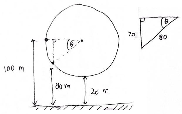

This is what I come up after trying to understand this hint
Let say the roller coaster starts from the leftmost part of the circular track (since the radius is 80 m and the bottom part of the track is 20 m above ground so 100 m will be at the middle of the circular track).
It moves downward to height of 80 m and the area swept by it will be in the shape of sector of circle. I try to find the angle of the sector, ##\theta## , by using trigonometry:
$$\sin \theta = \frac{20}{80}$$
Then I use the formula of arc of circle to find the path length: ##\text{arc}=\theta.r##
Next, I find the time taken to travel each arc, using ##t=\frac{\text{arc}}{\text{speed}}##
I repeat this working for each part of the arc traveled by the roller coaster (there are 4 arcs in total) and add all the time to get the time needed by roller coaster to travel from height of 100 m to 20 m
Is this the correct approach?

I'm not sure about ##\sin(\theta)=20/80##, what triangle did you draw to get that?
I am sorry I don't have my phone right now to take the picture of my drawing. I will send the picture as soon as I have my phone

Handwritten diagram of a circular roller coaster loop on the ground with a 100 m height marked, 80 m and 20 m heights labelled, and a right triangle with sides 20 and 80 and angle θ.
That looks good to me. Sorry, I had drawn my own picture but I did it in a more complicated way and mislabeled something and got the wrong answer myself.
