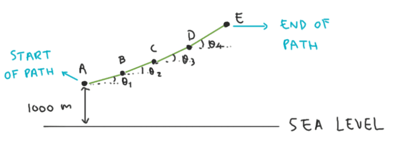

We are required to find the paths with the lowest and highest possible altitudes at the point 3,300m from the start: these paths will have straight sections with 'kinks' at each measured point.
Hand-drawn diagram of a path rising from point A to point E, with intermediate points B, C and D, each marked by an angle θ1 to θ4 with the horizontal. A 1000 m height is marked above sea level, labelled START OF PATH and END OF PATH.
Based on your hint, I image the path will be something like that, where:
AB = 950 m and θ1 = 7o
AB + BC = 1500 m and θ2 = 12o
AB + BC + CD = 1800 m and θ3 = 15o
AB + BC + CD + DE = 3300 m and θ4 = 20o
Is that correct?
If that is correct, I think I will be able to answer the question. I just need to find the elevation at each point (from B to E).
HB = 1000 + 950 sin 7o then I just repeat the process to get all the elevation and the lower bound will be the elevation at point D and upper bound will be the elevation at point E.
Is my idea correct?

songoku said:
Is my idea correct?
Yes, that should give you the greatest possible elevation, what about the least?
The greatest possible elevation would be:
HE = 1000 + 950 sin 7o + 550 sin 12o + 300 sin 15o + 1500 sin 20o
and the least possible elevation would be:
hE = 1000 + 950 sin 7o + 550 sin 12o + 1800 sin 15o
Is that correct?

The angle of elevation at 950m along the path is 7°, but where does it say it must be that at 949.999m?
Would it be like this:
The least possible elevation = 1000 + 950 sin 0o + 550 sin 7o + 300 sin 12o + 1500 sin 15o
Thanks
