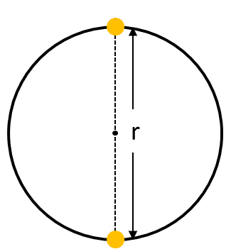

If r is the distance between the particles (assuming that they are on the opposite ends of the stationary point), the radius of orbit is r/2. Hence,
[tex]\frac{pc}{r/2}=-\frac{dV(r)}{dr}[/tex]
[tex]2pc=\frac{\alpha e^{\beta r}(2\beta r-1)}{2\sqrt{r}}[/tex]
[tex]E(r)=V(r)+2pc[/tex]
[tex]E(r)=\frac{\alpha e^{\beta r}}{\sqrt{r}}+\frac{\alpha e^{\beta r}(2\beta r-1)}{2\sqrt{r}}[/tex]
[tex]\Rightarrow E(r)=\frac{\alpha e^{\beta r}(1+2\beta r)}{\sqrt{r}}[/tex]
But is it correct to assume that particles revolve as shown in the attachment?
We're not given a good description of the model, but the circular model of motion best fits what we are given. The particles have to stay a constant distance of r from each other, while being in motion at a fixed speed c. That's a circular orbit with the particles diametrically opposed while moving in the same sense (either both clockwise or both anticlockwise).. If it were anything other than a circle, the distance would not be constant. If the particles were not diametrically opposed, the distance would be constant, but not r. If they were not moving in the same sense, the distance wouldn't be constant.
