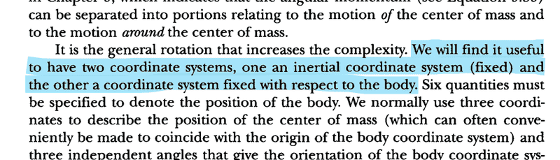

Hello. I am reading Classical dynamics of particles and systems(Book by Stephen Thornton), I have problem in understanding the coordinate system they choose to define angular momentum for a rigid body. At the beginning of the chapter 11 they say:
They use 2 coordinate systems to describe motion of a rigid body. One is the fixed coordinate system. In this system we can use Newton's law of motion without any problem. The second coordinate system is fixed with respect to the body. In the inertial reference frame, the rigid body and the second coordinate system move in sync, causing them to remain stationary relative to each other. So if a rigid body consist of ##n## particles with mass of ##m_{\alpha}## in this system the particle ##\alpha## doesn't move. I can say that it doesn't have momentum in this system because it is fixed with respect to it.

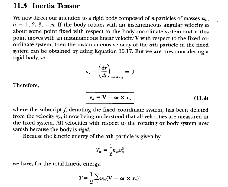

Following that, they demonstrate the process of deriving an equation for the kinetic energy of a rigid body.
If we make the origin of the body corrdinate system coinside with center of mass of the body, it results in:

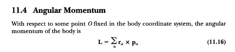

Up to this point, everything is clear. The issue arises in the next section, where they introduce the definition of angular momentum for a rigid body.
I cannot understand this. If point O is fixed in the body coordinate system, it could be any point on the body because the body doesn't move in the body coordinate system. Therefore, the angular momentum of this rigid body with respect to a fixed point in the body coordinate system should be 0! I believe the angular momentum should be defined with respect to the fixed coordinate system rather than a fixed point in the body coordinate system. Am I wrong?
Any help would be appreciated.
Even if O is fixed, the rest of the body would rotate around O.
But I think If point O is fixed in body coordinate system it should rotate with body so the body should be at rest with respect to the point O and it shouldn't have momentum.

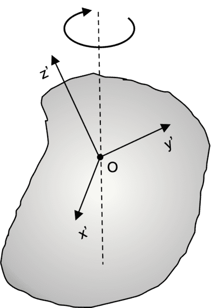

Here is what I think. The axis of rotation of a rigid body is a straight line consisting of all points that are fixed in space relative to a non-rotating inertial frame, while the rest of the points rotate with angular velocity ##\vec {\omega}## about it. In the picture on the right the rotation axis is the dotted line. The primed coordinate system is rotating with the body except for the origin O which is on the axis.
Point O, as all other points on th dotted line, is not rotating by definition. not only because it is on the axis, but also because, as a mathematical point, it has zero extent. You cannot tell if it is rotating or not. If you are an observer at point O and at rest with respect to it, you will see all the points in the rigid body (except those on the dotted line) move with respect to you. The only line that you see fixed on the rigid body is the dotted line, the axes will be rotating.
That's because you have to think of yourself as a "point" observer at rest on the dotted line. It is only human to think of ourselves as extended beings with points off-axis and that's where the fallacy understandably occurs, in my opinion.
