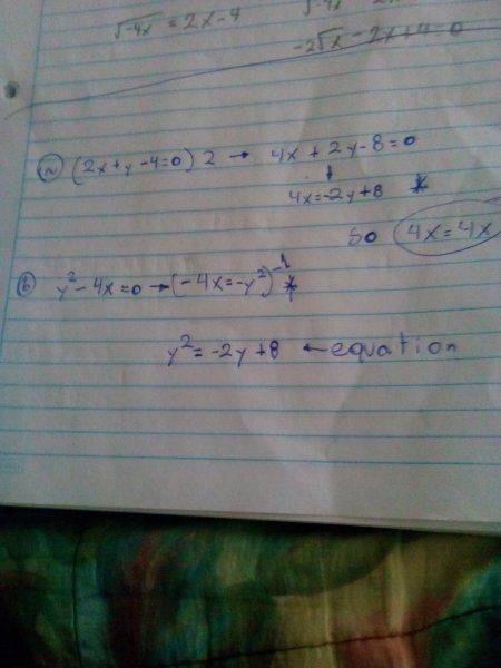

The problem ask for points of intersection of two functions
1: 2x+y-4=0
2: (y^2)-4x=0
My attempt of solution its in a picture attached below...
I get stuck in this two equations
1: ((y^2)/4)+(y/2)-2=0
2: square root(-4x)-2x+4=0
What. Can i do whit that two equations
I ve tried the square formula and given a weir and nonsense result[/B]

No picture included.
Multiply first equation by 2 then add equations to eliminate x.

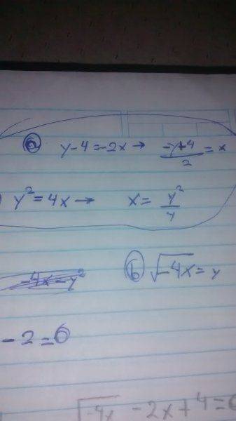

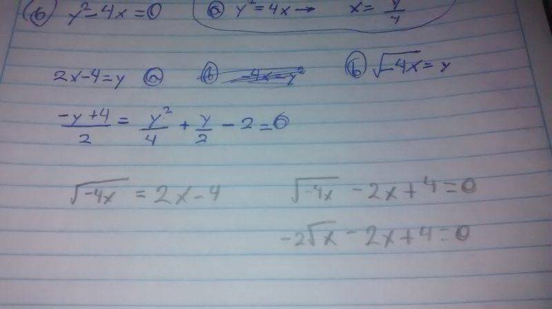

This is the picture of my work
How do you get ##\ y=\sqrt{-4x}\ ## ? Specifically, where does that negative sign come from in under the radical ?

That was incorrect. Anyway, much simpler is your first suggestion: Multiply first equation by 2 then add equations to eliminate x.
Equivalently, multiply the first equation by 2, then write it as 4x= 8- 2y so that the second equation can be written [itex]y^2- 8+ 2y= 0[/itex] or [itex]y^2+ 2y- 8= 0[/itex].
Thanks i will do that, but what is the point of multiply by 2? Dont change the integrity of the next equation?
Multiplying an equation by 2 gives an equivalent equation. Right ?If you want to use the method of substitution, it's better to solve one of the equations for x rather than for y. Then substitute that into the other equation. That way you don't take a square root.

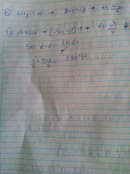

What is thw diference between this and the above equation? Pictures i mean
Mrencko said:
What is the difference between this and the above equation? Pictures i meanView attachment 82841
Maybe not much? I didn't like the ##\ \sqrt{-4x\ }\ ##. Especially since x had to be positive.What is your ultimate goal here?
Find the x and y intersections, i think this is finally solved, but my only doubt, if is this is posible to solve trought this equation:((y^2)/4)=(4-y)/2

Find the x and y intersections, i think this is finally solved, but my only doubt, if is this is possible to solve trought this equation:((y^2)/4)=(4-y)/2
Why not ?
If i use the quadratic form whit that equation i get, irrational numbers
You shouldn't.
Please show your calculations.
i went out for vacations, and somehow now its clear for my using the two metods and two equations, i am very grateful for the help, cheers guys :)
