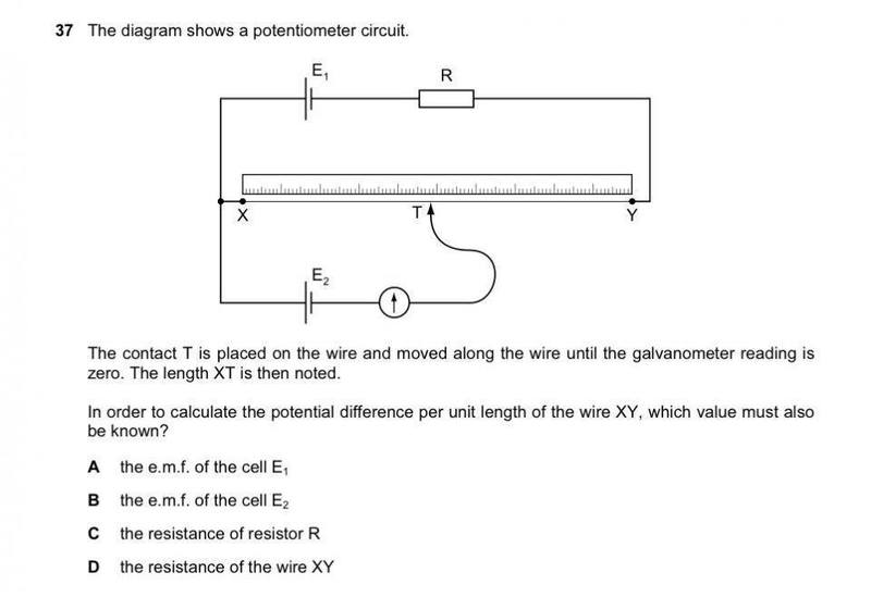

The answer is B. But I thought E1 needs to be be known first in order to find E2... And why not the resistance of the wire XY?
E1/ Rxy = E2/ Rxt
Then, in order to find Rxt, we need E1, Rxy and E2?
Suppose that you know E2. What can you say about the potential at T with respect to X?
Note that you're looking for the potential difference per unit length, not the resistance or resistance per unit length.

E1-E2?

No. E2 is not connected to point T.
I'm confused .. Why isn't E2 connected to T?

Because there's the lengths XT and TY of resistive wire between E2 and T. There is some (unknown) current running through those lengths, causing potential differences.

Okay.. So the p.d. across XT is XT/XY x E1?

No. Forget about E1 for now; you don't have a value for it. What you are to assume is that you know E2, and that the galvanometer reading is zero.

Potential at T is equal to E2

Right! Note that it doesn't matter what E1 is. As soon as the galvanometer shows zero current, the potential at point T must match E2.
Can you now work out the potential difference per unit length of the wire XY?

Yeah! It's E2 divide by the length XT. Thanks !
