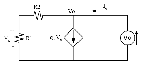

I see. Let's concentrate on R'eq first. Start by having a look at what depends upon what in the circuit.
gmvx is what's known as a dependent current source. The current it produces is a function of the voltage across R1 (Vx) The voltage across R1, in turn, depends upon the current flowing through R1 (and R2 since the two are in series). This current is set by the voltage that appears at the right hand end of R2 where it meets the top of the dependent source. All right so far?
Now, one way to determine the resistance of such a network is to imagine a fixed voltage source, let's call it Vo, attached across the network at its output where you want to find the equivalent resistance. This voltage source will drive a current, call it Io, into the network. The resistance of the network is then given by Vo/Io.
You should be able to solve for Io in this circuit. Start by determining the current through the resistors and finding Vx.

Alright I understand that, and I know that once the current Io is driven into the network an equivilent amount of current must be driven back out (KCL - [itex]\sum[/itex]currents in = [itex]\sum[/itex]currents out). With this being said Io = Current over R1 + Current over R2. The current over R1 is IR1 = Vx/R1. I am on the correct track so far right?
The current through R1 and R2 is the same; they are in series. So don't add the current in each! And Io is going to split between the resistor path and the controlled current source path; Those two currents will sum to Io. At this point in time Io is the unknown that you want to solve for.
Vo is fixing the voltage across the series connected R1+R2. So find the current through the resistors using Ohm's law. Then determine Vx, again using Ohm's law. This Vx will then depend only on Vo and the resistor values.
I feel like I'm making this more difficult than it needs to be and end up confusing myself, so I apologize in advance for the dumb statements/questions :redface: so just to be sure there's no confusion and to answer your questions/statements - the current through the resistors is Vo/(R1+R2)
Yes :biggrin:
So if that's the current through R1, Vx must be ______ ?
gneill said:
Yes :biggrin:
Vx = ([itex]\frac{Vo}{R1+R2}[/itex])R1
Yup.
So now you can use this expression for Vx to get rid of the Vx in the controlled current source. Voila! No more unknown Vx.
Time to find Io. You have the current through the resistors, and your newly minted expression for the controlled current source current. What's Io?

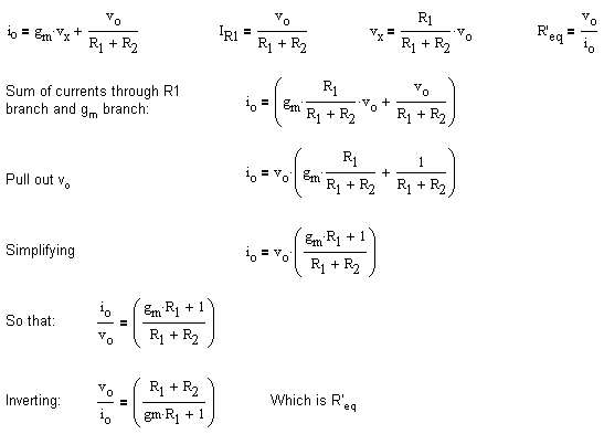

I believe:
Io = ([itex]\frac{Vo}{R1+R2}[/itex]) + gm([itex]\frac{VoR1}{R1+R2}[/itex])
Yup again :smile:
So now you can form Vo/Io, yielding the equivalent resistance R'eq.

I attached what I got for R'eq:
Alright. I see that you've put in I(R1 + R2) for Vo. Why not leave Vo as is and then it'll cancel with the Vo's in the denominator. All the unknowns and 'working variables' will then have 'vanished', leaving just component values. You can then simplify the expression a bit more.
Yeah when I initially did that it seemed a bit cloudy, I gave what you suggested a shot and think I have found it through algebra:
Bravo :biggrin: A nice, simple expression for R'eq.
To summarize the plot so far: The circuit was "broken" to remove R3, and the equivalent resistance of the remaining network, R'eq was found by applying a fixed voltage source Vo to the network at that point and determining the current it would produce. The math went (essentially) as follows,

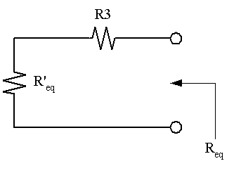

Awesome :biggrin: question: what exactly do you mean yielding Req? My first instinct when looking at this was that R'eq and R3 would be in parallel since they 'shared' the same node
If you look again :smile: I think you'll find that they are in series.
Awesome! I didn't think of it like that - I figured the node to the left of R'eq meant it was in parallel (stupid mistake I know). So all I would do is have R'eq + R3 = Req
