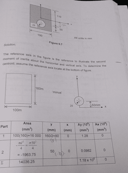

determine the second moment of inertia about the horizontal axis and vertical axis for the shaded area with respect to x and y axes through the centroid of the area .
Since the x and y axes is drawn thru centroid , why not the y for part 1 = 0mm ? y for part 2 = -30mm?

Because the axes being used for the calculation are not the same ones shown in Fig. 6.7. The calculation axes are shown at the lower right-hand part of the page, just above the table.
You must read the text in order to follow what is going on; you can look at one picture and assume it applies regardless.
