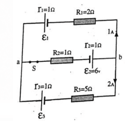

This circuit is given:[/B]
What are the values of ε1 and ε3?
IR=V
I get the right answer for ε1 (3V).
But I get that ε3=12V and not 15 (the answer in the textbook).
First the charge from a to b is 3A.
Then I simply use Kirchhoff's second law, which gives: 2Iab-6+10+2-ε3=0.
That gives ε3=12.
Am I wrong or the book? Maybe the charge from a to b is not 3A?
book is wrong
How could that POSSIBLY be true? If it were, then the currents into/out of node b would not add up to zero. A miracle.
