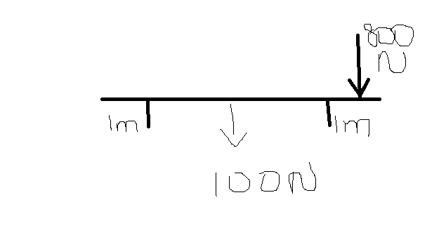

1. A horizontal, 10-m plank weighs 100 N. It rests on two supports that are placed 1.o m from each end. How close to one end can an 800-N person stand without causing the plank to tip?

Your diagram is not the most useful since it shows the person right at one of the supports. Redraw it with a bit more overhang for the person to stand on. Draw in the relevant forces. No need to draw a stick figure, just indicate the force of the weight of the person. What equations do you know for static equilibrium?
for static equilibrium? I know ΣF = 0

what does the fact that the body is in static equilibrium indicate to you?
that there are no external forces??
mmm no.
what do you know about torques in static equilibrium ?
I know torque = force x level arm
when a rigid body is in equilibrium then it means that the sum of torques = 0
try to write both
1)∑F=0
2)∑τ=0
for your system
