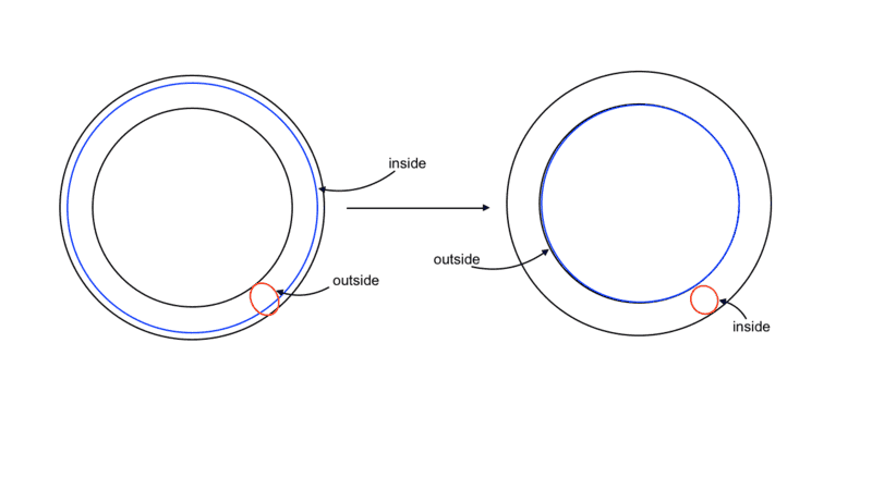

Okay so here is my second attempt
I use the same process as earlier that is I increase the size of the hole such that the tube is now a strip, and the hole is increased such that blue circle remains intact but the red circle is cut into a line, now if we flip this strip and stitch it back together we can see that red circle which earlier was wrapped around the blue circle is now wrapped outside the blue circle.
And the blue circle which was earlier on the inside surface after flipping comes on the outside surface and the red circle which was out is now on the inside surface thus they are untangled! i.e., they are no longer linked

So it should look somewhat like this,
Which of course is impossible. How did they pass through each other?

So that means that we cannot increase the length of the hole such that the tube is converted to a strip?
Because by this method it does completely makes sense why the red circle passed through the blue one (because we literally cut and stitched the red circle in the process)
But yes if that is not allowed then it is way too hard for me to imagine how a tube is inverted inside out through a small hole, infact I cannot believe how can people do this in their head! 🤯

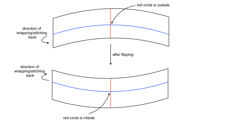

Wait, can we cut it such that we get a rectangle? doesn't that break any rules? is a toroid with single hole isomorphic to rectangle?
I agree that with can cut it in both ways that you mentioned, i.e., cutting it such that we get a short fat cylinder and cutting it such that we get a long narrow tube (as it makes sense that a short fat cylinder when stretched along its length gives a long narrow pipe) but how can we do both of these together to get a rectangle?
Consider a short fat cylinder, which can be thought of as a rectangular strip of paper whose shorter sides are joined together, now if we want to get a rectangle from this strip, we will have to cut this strip and cutting is not equivalent to increasing a size of hole. As I understand increasing or decreasing the size of hole is allowed but cutting or stitching two surfaces aren't allowed.
I only increased the size of the hole in my attempt, and then flipped the strip (short fat cylinder) inside out and decreased the size of hole in reverse such that we got back the original shape with which we started with.

I was thinking about this a lot and even though I don't know how it will happen but I think that it should happen, i.e., the red and blue circles shouldn't be linked after inverting the tube inside out.
This is because, the red circle which was initially outside the tube, after flipping has to be inside that tube, and similarly blue circle which was initially inside, has to be on the outside after flipping. Now it doesn't matter where the blue circle is on the outside, as long as the red circle is inside the tube, both of these circles cannot be linked!
And this makes me think that those two circles weren't linked in the first place itself! And that must have something to do with the fact that our tube had a hole in it. If there was no hole then it makes sense that both circles are linked and cannot pass through each other.
Now what I think is happening is that, as we are pulling the inside surface of the tube out it passes through the inside of the red circle, now again I am not clear about how is that happening, I was finding toroids in my home and the only similar thing I found is my bicycle tube but to access that I'll have to rip off my tyres! Why don't we produce more things that are toroids? The other alternative is that I have to cut my shirt's sleeves and then stitch it end to end but I don't think even this is a good idea.
Given that we are allowing cutting the strip and laying it out as a rectangle we can dispense with the hole; except that when we reassemble it as a torus it must be equivalent to having pulled it through a hole.
As I mentioned, there are two ways we can stitch the rectangle back to be a torus. Obviously one way will get exactly back to where we started. What happens if we do it the other way?
But why is cutting the strip allowed? wouldn't that change the shape we are dealing with?

Try it with a sheet of paper. Draw a line across the width on one side and along the length on the other.
You can turn it into a cylinder by bringing together two opposite edges and gluing them together, then into a torus by doing the same with the opposite ends of the cylinder.
You can do it either so that the first fold leaves the line inside as a circle and the outside line straight, or so that the outside line is a circle around the cylinder and the inside line is straight.
Check linkage of the lines in the finished torus in each case.

Anyway, to the conclusion, the blue circle are red circle are not linked like a chain in one but they are linked in folding the other way around as I expected. 100% their linkages are different, they have to be different!
kshitij said:
Well first I learned that making a cylinder is relatively easier but making a toroid is way too difficult, the paper doesn't want to change its surface's curvature and IIRC there is a theorem like that by Gauss (??).
Right, but for each of those two ways of folding the paper there were two ways you could have done it. If the lines are red and blue, your first fold could have have formed a circle on the inside with either the red line or the blue, or formed a circle on the outside with either the red or the blue.
So the reconstructed torus has any of four configurations:
Linked rings, red inside, blue outside
Linked rings, blue inside, red outside
Unlinked rings, red inside, blue outside
Etc.
The question becomes, which of the possible transitions could pulling the torus inside out through a hole produce? If it started with red outside, blue inside then obviously it ends with red in blue out, but they could be linked or unlinked.. and it should be obvious the linkage status cannot change.
  • Love
Etc.
The question becomes, which of the possible transitions could pulling the torus inside out through a hole produce? If it started with red outside, blue inside then obviously it ends with red in blue out, but they could be linked or unlinked.. and it should be obvious says the linkage status cannot change.
Oh yes, I see it now,
If we did the first fold horizontally (and the horizontal fold should be in opposite direction to the unfolding otherwise we will end up with what we started with) instead of vertically then the circles won't be linked and thus that is not what is happening in inverting a tube with linked circles!
Also I noticed that the tube was narrower and longer before inverting it inside out.
